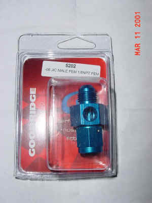

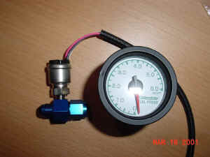

What about an inline T sensor adapater right after the fuel filter? That's where we splice in on the MKIV TT...
