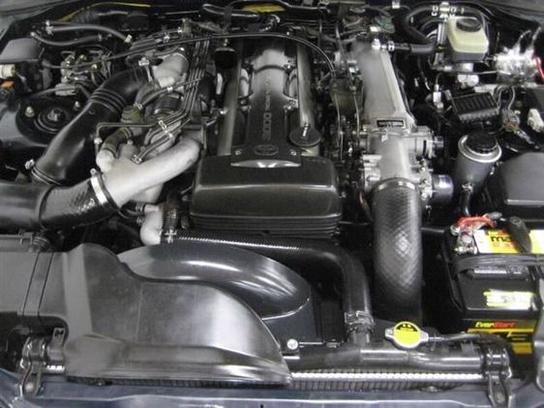

Was looking into a '97, but was also looking at a '94 TT with a great price, the only turn off really was the miles..What do you think?
Current miles: 88,929
1994 TOYOTA SUPRA TWIN TURBO.. BONE STOCK.. ALL ORIGINAL.. NO PAINT WORK.. CLARION CD PLAYER.. LEATHER.. LOW MILEAGE.. FULLY SERVICED.. HANDFUL OF SERVICED RECORDS.. ADULT OWNED.. FLORIDA CAR..
A few little dislikes, one that it has that aftermarket cd player, that it's not a T-top, and I love the '97 front and back ends..minuscule details but would like to hear some feedback. Also any extra recommendations to ask about/look for when buying a car like a Sup? I know test drive and compression test of course.
