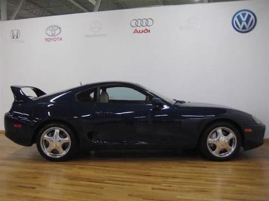

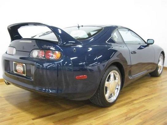

Was looking into a '97, but was also looking at a '94 TT with a great price, the only turn off really was the miles..What do you think?
Current miles: 88,929
1994 TOYOTA SUPRA TWIN TURBO.. BONE STOCK.. ALL ORIGINAL.. NO PAINT WORK.. CLARION CD PLAYER.. LEATHER.. LOW MILEAGE.. FULLY SERVICED.. HANDFUL OF SERVICED RECORDS.. ADULT OWNED.. FLORIDA CAR..
A few little dislikes, one that it has that aftermarket cd player, that it's not a T-top, and I love the '97 front and back ends..minuscule details but would like to hear some feedback. Also any extra recommendations to ask about/look for when buying a car like a Sup? I know test drive and compression test of course.
ID:	4525   Click image for larger version
Name:	baltic blue 2.jpg
ID:	4526   Click image for larger version
Name:	baltic blue 3.jpg
ID:	4527   Click image for larger version
Name:	baltic blue 4.jpg
jzzrs180 is offline   Reply With Quote
Old 03-28-2012, 12:58 PM   #7
Codyjamesuno
Join Date: Jan 2011
Posts: 65
thats low miles if you ask me as long as its been maintained. Looks like a nice find, but the TARGA is an awesome option that I would not go without.
Good Luck!
