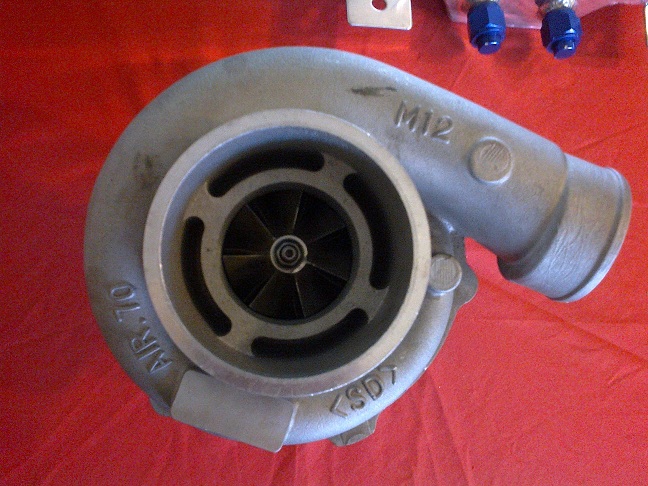

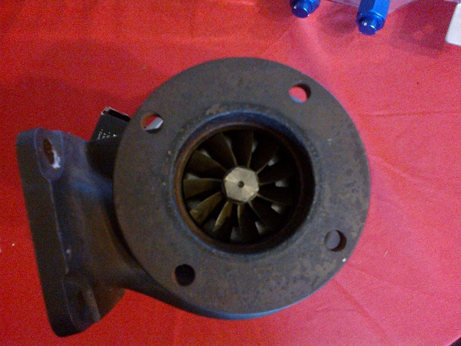

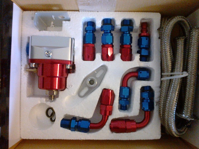

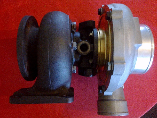

Not sure wat size it is bought it off my friend it has a A/R 70 with a 57mm and the exhaust not sure the outlet is 70mm havent striped it to take size but wil make it bigger not a problem or sell it and get something else.

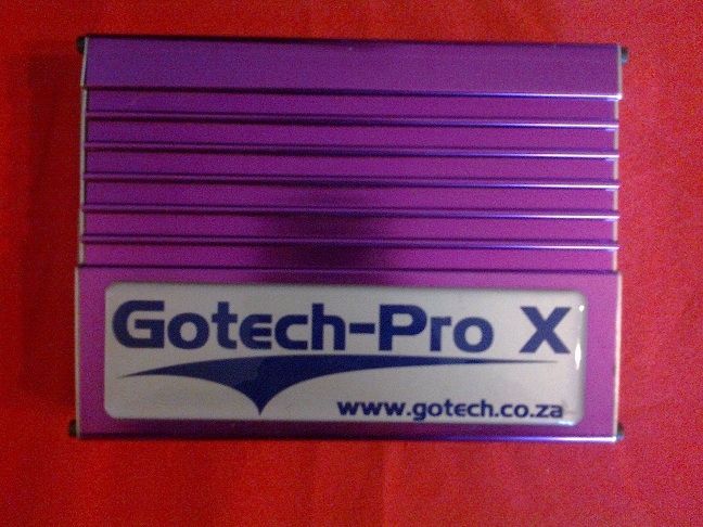

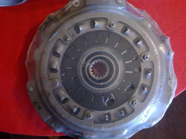

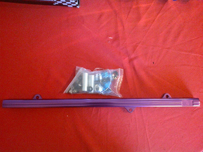

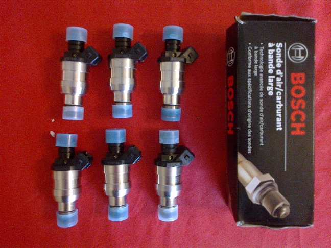

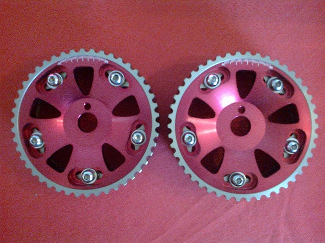

Wil take some pictures this weekend off my supra must just push her out the garage.And the AR on the exhaust im also not sure there is no marking to indicate size would gess so .63.Some more pictures

Name:	Injectors and AF sensor.jpg

Name:	cam gears.jpg

...2) Its basically that know its not a good make but the brand names are very expensive and cant find any 2nd hand ones....
Please post up a picture of it.

one of the oem turbo wastgate port is starting to crack so need to replace them and would rather use a single turbo
I really dont think im gone be able to get the oem ecu tuned here and the web addres is www.gotech .co.za
The flywheel is stil a piece of solid alliminium must stil start with it.
Dont worry about the speed of the 1km then wil just see wat speed it gets on the 1/4 setup.

The oem ecu can't be tuned - at least not without extensive (and expensive and impractical imho) internal modifications - so I agree that's not an option at all, anywhere. However, just because the oem ecu can't be tuned, that doesn't mean you should tear it out. There are several good choices for relatively inexpensive and easy-to-tune fuel controllers (aka 'piggyback' ecus) that leverage/retain all of the oem ecu's tuning. For example, have you considered this device?
http://www.titanmotorsports.com/afcneo.html
If you can find one used, it should be quite affordable. Unless you object, I'll recommend you sell that gotech ecu, and install an afc neo - okay? Let's call that TSI modification#1 for your project.
Note: I'm assuming you'll sell the fuel cell, the gotech ecu, and anything else we don't use - right????
TSI Modification#2 will be to get your turbo situation squared away. Even a relatively small single turbo will get you into the 10s, so let's go ahead and use that 57mm, .70 a/r turbo you've already got, on that godspeed header. Install it all with a Tial wastegate, and run all hoses and lines.
Preferred alternative: Purchase and install a 100% complete turbo kit:

TSI Modification#4: I need more info here...what was wrong with your oem clutch and/or your oem flywheel? Also, you posted a pic of a what looks like a new pressure plate - what brand is it?
For a 10 second pass, you'll need an aftermarket pressure plate (with greater pressure than the oem pressure plate), and an aftermarket clutch disk - the one you posted up looks fine. Either a new oem flywheel or an aftermarket flywheel will do fine. If it's not too late, I'd opt for a steel flywheel rather than an aluminum one - you need mass in the flywheel to keep the wheels spinning off launch and in between shifts. A flywheel that's too light will allow the driveline to lose too many rpm too quickly, and will make for a poor drag race setup.

TSI Modification#5: Fill with E85, and tune the AFC Neo and the aftermarket FPR until it runs. Don't tune any specific RPM ranges yet - just the overall baseline. You may need to change the MAF input to 1/2 (the AFC has a setting for this), which will reduce the volume of fuel squirted into the engine by 1/2...which may be all you need as a starting point, along with a base fuel pressure of about 35psi (oem base is 44psi). Oh, be sure you install a boost gauge and an air/fuel gauge (either wideband, or one that uses the oem O2 sensor). An EGT gauge would be good/useful too.

That neo do you wire it in or is it plug in.Just asking wat is the reason for not using the gotech or is the oem ecu that good. what about al the old sensors wont it make problems on the ecu if its disconnected. Just have a look at this chip.
http://www.dastekpower.com/home.htm
TSI Modification#2 Forgot i do have a wastegate will sent pics

TSI Modification#4: The clutch was on its wear limit.Took the clutch in and made it 5 puck button.The pressure plate is also made stronger
The old oem flywheel is very loose can turn it 45 degrees still need a flywheel.

...TSI Modification#3: Do i need to upgrade the oem fuel pump or is it okay...
Each oem denso fuel pump can relaibly push about 550rwhp worth of gasoline or about 320rwhp worth of E85 (6spd)
The old oem flywheel is very loose can turn it 45 degrees still need a flywheel....
Why not a new Toyota flywheel? It's great for both drag racing AND regular street driving.
