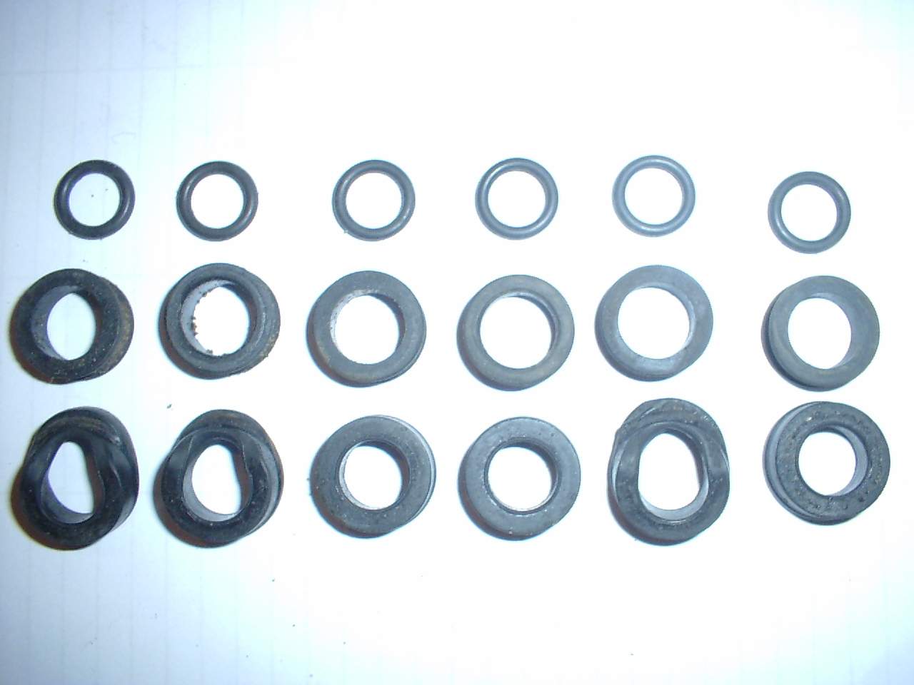

Well to start I had this JDM engine installed here in the local scrapyard by the afghani's about 6 months ago (they said they don't like the taleban btw). I've allways had a slightly rough idle and lately the idle did the old up and down routine to 1800 down to norm constantly. I changed all the intake manifold gaskets except the ISC valve which I had to make myself as they company here didn't have one.
Well to make a long story short, none of the above fixed the problem. 25 and 26 started about a week ago and came on twice.
The attatched photo shows the culprits. They are my old injector packings that were installed by the taleban militia and as you can see the 3 on the bottom were pinched during installation. I showed them in the pic upside down to better show their distortion.
I put in the new packings and now it runs smooth and has a bit more power.
