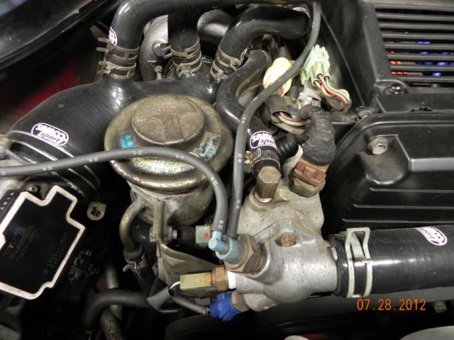

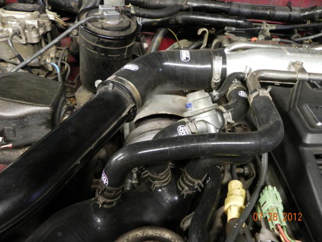

In order to make sure I remember how all these hoses and wiring goes back together I am taking pictures of everything I do along the way. Here are some before pics that should come in handy later.
