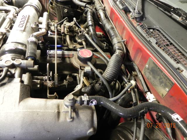

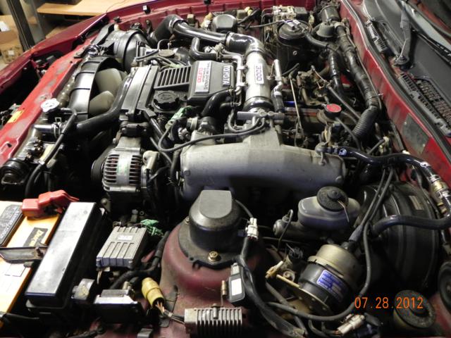

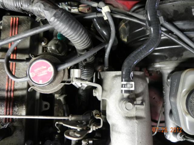

More before shots

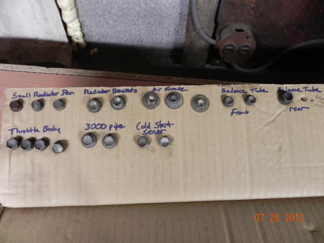

If you want to remember where all of your screws go, this tip in my opinion is priceless. Somewhere along my projects I learned to take a piece of cardboard, and do this....Might be over the top, but I can pretty much assure you I wont get stuck bolting it all back together.
