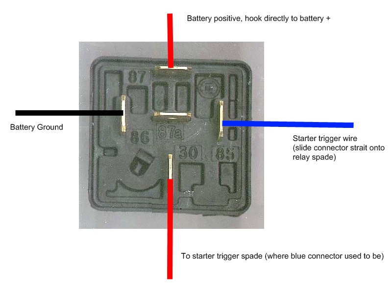

This is an extremely common problem in these cars. The signal wire going to the starter gets old and starts to have resistance, not allowing full power to go to the starter trigger solenoid, therefore it can pull the solenoid so far, but not far enough to get the contacts to touch for the starter to turn. That is why you hear a single click. It is an easy fix, you just have to wire a relay into it. Wire it as such using a wire as big or bigger than the original blue trigger wire. Use these crimp on connectors, they slide strait onto the relay spades and the starter spade. With this circuit, you can use the weak blue signal to trigger full battery voltage to the starter.
RadioShack.com - Cables, Parts & Connectors: Connectors & connectivity: Crimp connectors & terminals: Crimp-On Quick Disconnects (6-Pack)
^ those come with male and female connectors, but you only need the female ones. You will need 4 female connectors so you would have yo buy two packs. Hope this helps you. If you want proof that this will work, hook a jumper wire from the battery positive terminal strait to where the blue trigger wire connects on the starter, and watch it crank everytime.

Because that is not the problem. There are two wires that go to the starter; the positive battery cable, which is heavy gauge, and the small, blue trigger wire, that only receives current when the key is turned to start. The problem is the trigger wire, not the big positive cable bolted to it. When you turn the key to start, current goes through this blue wire, energizes a coil of wire making magnetism, and pulls a plunger, when this plunger is fully pulled, it connects two more contacts, the positive batter cable and the bigger coil of wires that turns the starter. The problem is over time that little blue wire gains resistance internally and doesnt provide enough current to pull the plunger all the way to the point where the other contacts touch, therefore you can hear the plunger moving, but its not going enough to make the starter contacts touch. This is why people usually experience this problem more when the car is hot ( heat=more resistance). So by using this relay, you can take the small amount of current supplied by the old blue wire, and use that to switch the relay which in turn will give full battery voltage.
This is not a temp. fix at all. It is permanent. You can take out your entire wiring harness from your car, trace the blue wire back through all its connections and all the other wires its involved with, and replace them all, or you can do a simple relay mod like many many others have done.

Copied from previous post HERE
One of the problems is the gauge of the wire, although probably ok when new, it is too thin and over the years the copper wire deteriorates, resistance increases due to age and the constant heat changes. This becomes more apparent when the engine bay heats up, the thin wire will also heat up, causing high resistance. A permanent fix is to fit a 30 or 40amp 12v relay in the engine compartment. Instructions below.
The thin wire from the ignition activates the coil in the relay which doesn’t need a lot of current. The switching part of the relay takes care of the amps required for the starter solenoid, The large wire going to the starter motor from the battery is the main power to turn over the starter motor once the solenoid is activated, this wire doesn’t need to be upgraded. Insructions;
1. Disconnect the battery
2. Fix the relay to the bulkhead or somewhere covenant.
3. Remove the thin wire going to the starter motor and connect it to terminal # 86 on the new relay
4.Connect terminal # 85 to earth (negative) using a 20 amp wireAt this stage you can check the relay is working by connecting the batteryand switching on the ignition as you would normally do to start the car. You should hear a click from the new relay but the starter will not turn over until you have competed the next steps.
5. Remember to disconnect the battery again
6. Connect a 20 amp wire to the spade terminal on the starter motor. (This is where the thin wire was once connected.) Connect the other end to # 87 on the relay.
7. Connect 20 amp wire straight to the battery and to # 30. connector on the relay. Job Done.
