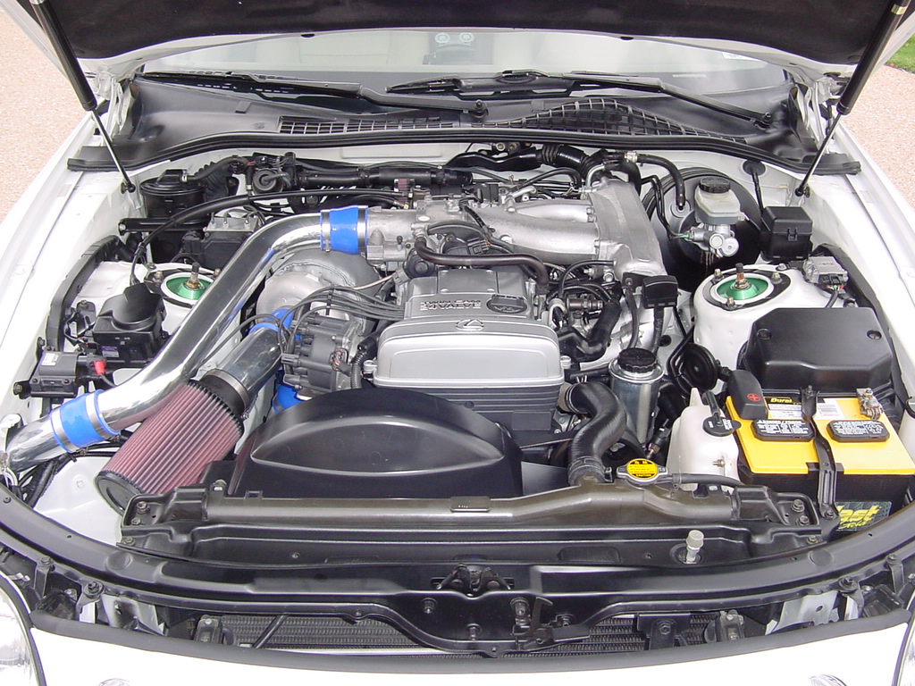

Turbo kits come with whatever you need to bolt up to the oem exhaust...typically a 'shorty-downpipe' off the turbo. Since aftermarket exhausts are designed to replace the oem exhaust, they will work with any (good) aftermarket turbo kit. Again, here's one na-T kit I can recommend:
http://www.boostlogic.com/catalog/p1...duct_info.html
...and here's where it mentions the components it uses to connect the new turbo to the oem exhaust:
- 3” SS304 Polished Downpipe w/ Flex Joint
- 3” SS304 Polished Midpipe
(The "SS304 Polished Dump Tube" only connects up to the new (aftermarket) wastegate).
It's a pretty good looking kit. Take a look at the results post-installation:
http://vrechise.com/getimage.php?i=sc3001.jpg
If all you want is looks with the exhaust, just cut the tip off the oem exhaust and get a nice aftermarket tip welded on:
http://www.summitracing.com/parts/mpe-35171/overview/
Again, an oem TT exhaust will flow 500hp just fine. However if the aftermarket turbo system you choose significantly exceeds that hp, you'll want to get a full aftermarket exhaust system.
