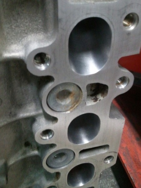

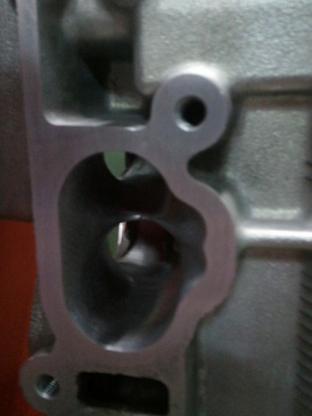

Here is a quick shot of the crank that came back from cleaning and polishing.
Here are the pistons ready for a series of different coatings being applied to them.
Here is a link to the process being done from the place coating the pistons. Piston Coating Here
I am also having the oil shedding applied to them as well for more street use and longevity.
Block machining has been started
