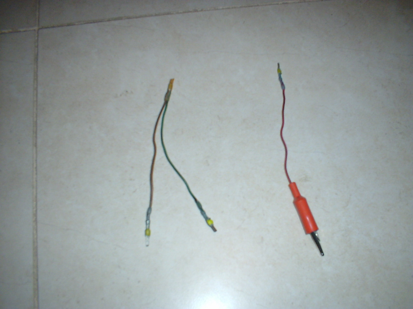

how do i check my codes on this car i am mew with supras

http://www.cygnusx1.net/Supra/Librar...aspx?S=FI&P=23
Use any wire or get a spare plug with 2 male pins and make your own jumper like I did.
