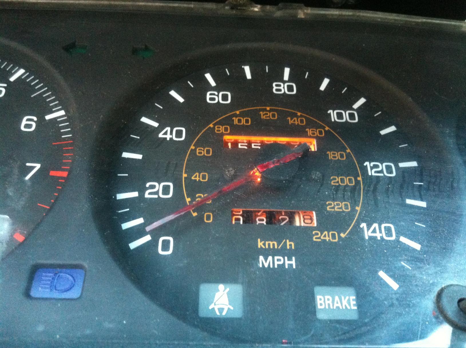

Thanks 907mge for the video, really helpful! So i pulled the dash earlier today and switched the bulbs with just some Eiko bulbs. And they worked just a tad bit better than what i had before, but im still not getting an efficient amount of light to the numbers. So im wondering is my problem probably just a matter of getting stronger/brighter bulbs(maybe some LEDs)? And I don`t know if im just trippin, but it seems like my MPH gauge is a little laggy? Is there suppose to be a certain cord for the speedometer or is it just all the cords that you have to remove and reinsert? Thank you to everyone!

Hi! Still belive you have a resistance problem , dim bulbs are due to a drop in available voltage ( that's what dimmers do ) OR - you have a problem with a poor earth (ground ) return . Can I suggest you invest in a voltmeter and carry out a thorough voltage check throughout the curcuit - and bench test the dimmer , start at the battery ,, check across the posts -12 volts minimum , THEN check across the ( -/+ ) posts to ( + /- ) battery connectors - this will give you a reading of the most voltage available in the loom and work through the list , battery connector -body , battery connector -engine , loom points-earth -etc . I had a problem with the earth post of a battery / connector once -cleaned with nylon pad and refitted - ok now.Also it could be a good idea to carry out a continuity check of the earth ( ground ) cables to body .Imagine trying to get a starter motor to turn if the earth ( ground ) cable is extremely corroded . high voltage drop - similar to a nearly flat battery .

Hi! Also , check that the alternator is charging the battery , this should be around 13.5 volts with the engine running and this voltage brightens the driving lamps , check by turning the headlamps on against a wall ,then start the engine ,the lamps should dim slightly while the starter is being operated ( volt drop ) then brighten ( extra voltage ) . this means there is 13.5 volts in the system . Always start with ancillaries turned off , this gives maximum voltage to the starter/ ignition system for easier starting with an old battery .If the lights go out during this process then the battery may need bench charging or replacing .

A lot of people find their lighting to be worse when using LEDs... bad hot spots and fast fall off. An aging dimmer circuit can often cause dim dash lights as well as aging bulbs.... old bulbs do not burn as bright as they did when new(er). To bypass the dimmer, unplug it and insert a wire jumper across the two striped white wires running into the dimmer's harness. White with black stripe to white with green stripe.
