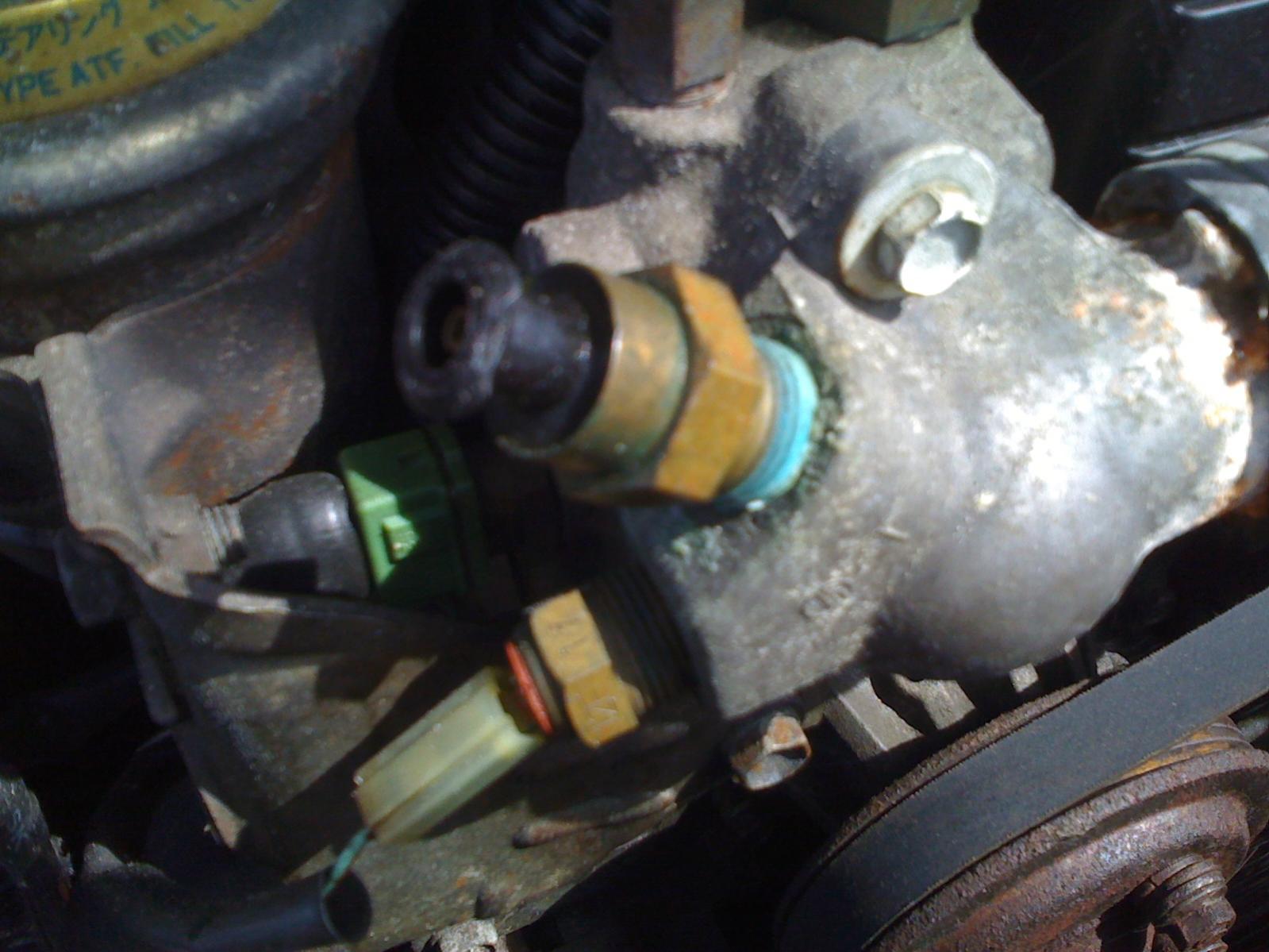

Hey, been here for a bit.. but finally getting back to my project 1987 7mgte. im about to get this thing on the road for further repairs that i cant do at my house... this car has an aftermarket fan installed but does not go on when car gets to temp.. the contol box for the fan has 2 slots that wires need to goto...fan was tested and works otherwise, question is ..what sensor @ the thermostat housing goes to the fan and kicks it on at the right temp??? a friend said "just hook it up to a switch" but i dont like that idea... also the BVSV has no vacum lines on it, charcoal canister is deleted along with A/C.. this guy plugged hoses i guess to bypass something...car runs fine, no codes at all, i just dont want an overheat...
i enclosed a pic of the broken bvsv and the name of the aftermarket fan "flex o lite"

That BVSV doesn't look like any Toyota BVSV I'm familiar with. The BVSV is part of the charcoal canister's system though, if you don't replace that then you don't need the BVSV. You can replace the BVSV with one from any Number of Toyotas you'll find at a salvage yard for a buck.... Or you can spend a fortune on a new one from Toyota, your call.
There is no switch on the 7M-GE or GTE which is suitable for an electric fan. You'll need to tap the thermostat neck or put a T in the heater hose line (AFTER THE HCV!!!) and install a proper thermostat. My recommendation (if you search the forum you'll find it often ) would be to ditch the electric fan, replace the fan cowl and install a lightweight flex fan and fan clutch. The switch is a bad idea on anything but a track car.
