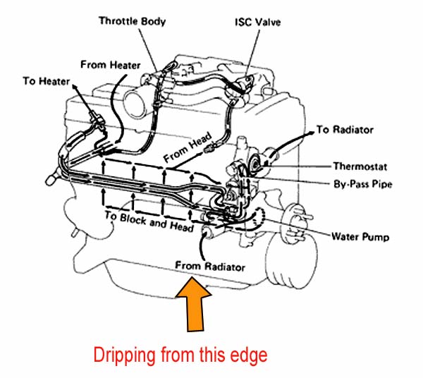

Well here we go again, just had head gasket check so that can't be it hopefully, but I popped my hood to start working on my AC compressor and I heard a hissing sound after returning from town. Trying to locate the sound it seems to be under the distributer and I found some slow droplets of water coming off the side of the block dripping a drop maybe once every 4 seconds beneath the exhaust manifold and to the right of the oil filter about 4 inches away toward the front of the car. I still have the same or near the same amount of radiator fluid so perhaps I have a hose going bad. I never replaced any of the hoses after 7 years of sitting so I am thinking this will be the first to blow....Oh Joy! I see that there is a metal water tube running behind the manifold. I suspect this first, what hoses are there? Any hints before I call my insurance company switch my insurance and drive my Geo? I guess I need to see a break down view cause it is hard to see in there with the distributer in the way. Finally get my car burped and I have to drain the damn thing for AC repair. Hoepfully it will be easier to burp when I get it back together.... Girfriend? Who has time? I am always working on my Supra and spending money on her!

My first thought is the rubber 90 degree hose that runs from that metal pipe you referenced to another line at or near the water pump. It runs directly underneath the water outlet housing and under the distributor....
I'll see if I can find a diagram of it, and I'll post back with my results.

This diagram will have to work, kinda a big pic though. I suspect hose #16283 in the diagram

Default Snake under the hood
I will keep that in mind and check that Thanks, I think however at least my first attempt will be the main lower radiator hose. It feels a little like soft aerated foam past the clamp and after getting the new replacement hose for $15 it is evident that the hose has swollen or stretched about 25% bigger to what it should be and is soft. The end of it is damp underneath though it is hard to tell cause after cool down no noise or leak was present and that area of the engine has oil build up from long time oil leaks that I just fixed. I will certainly inspect that hose you pointed out though. I'll let you guys know what I find. Check my post on AC conversion cause I am attempting my first evac and charge and wondering if I should go with the r-12 I have or the r134a conversion. I could use some advise. Thanks so much for the diagram. That helps.
UPDATE
REPLACED the lower radiator hose and it killed the snake all is well now... I wonder if this hose had been contributing to my overheating problem before?

hey on my n/a supra that i have before that 90 degree angle hose was broken and it was dripping just like that until it exploded and i have antifreeze everywere. verify that hose , the one on the diagram. good luck . Q

Here just put this in another post so its handy. The rusty pipe is were the 90 degree hose hooks to, you can see the hose under the pipe disconnected and sitting there. If I were you I would do what I did lol, replace the lower hose and the 90 degree at the same time since you have to take the same stuff apart to get to both. The 90 degree hose can be sourced from autozone or napa or anywhere just go in with the hose and tell them you want to see if they have anything that will match it in there hose section. Usually they just let me go back to the wall of hoses and match it myself because they dont want to. But should be able to match one for $15 at most, may have to cut it down from a longer one but not hard. I think I paid $7 for the one I got. Sorry didn't write down the part number. At some point you should just save up the money and replace every hose on the car, that is the best way to make it the most reliable and will only cost $100 or so for all of them. here is the pic
