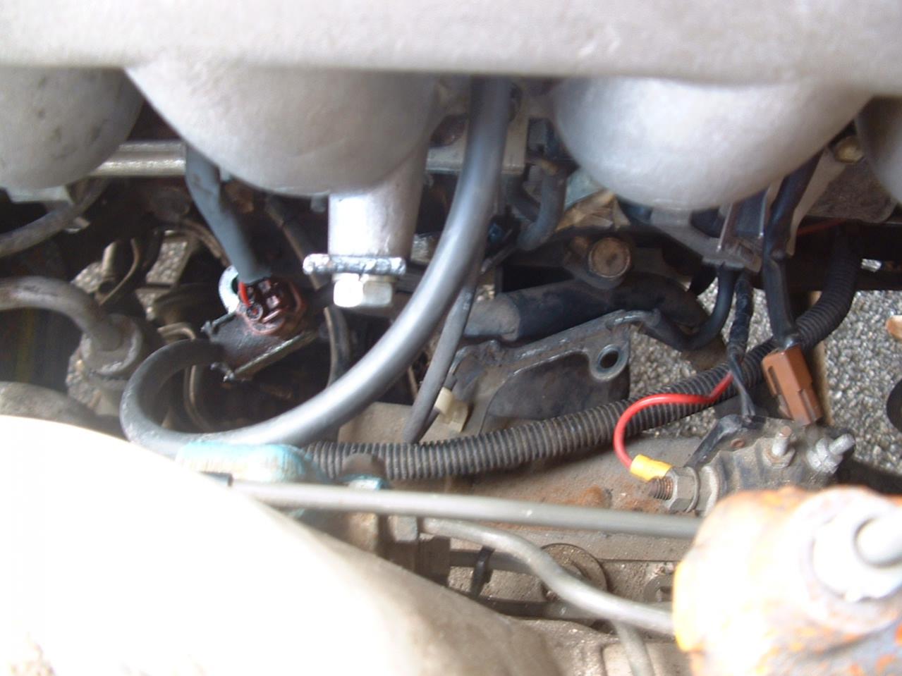

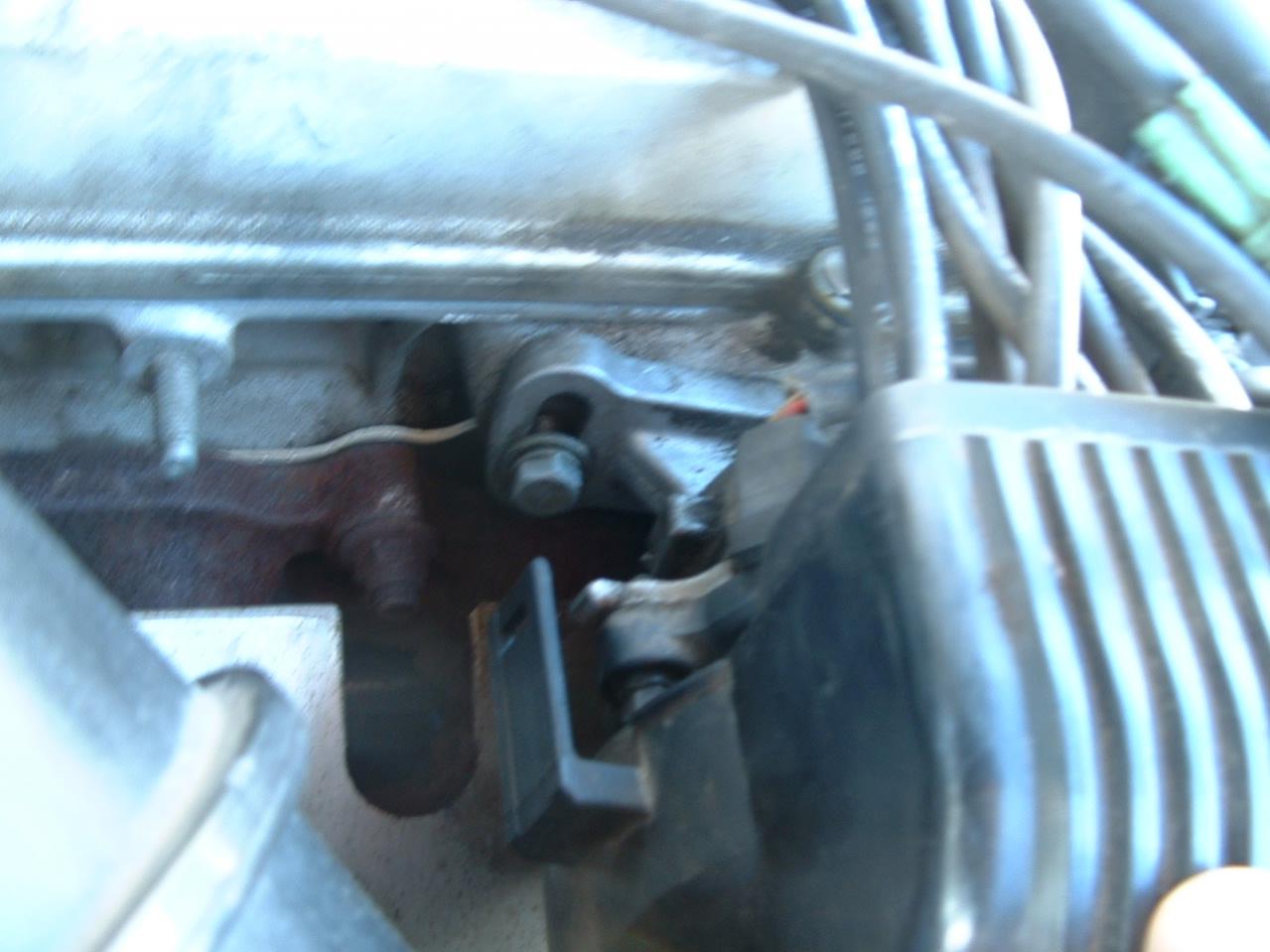

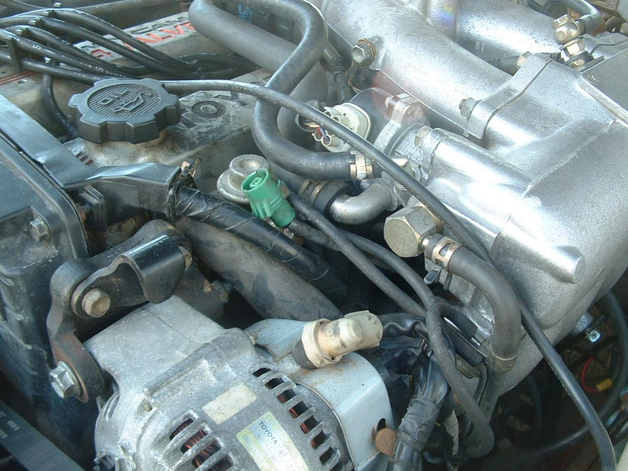

I just bought a 1986 Supra HB 5 speed about 100 miles from the house. The seller says that the following work has been done after the car owner brings it to him apart. Seems like a honest guy running a small repair shop, he tells me he had to purchase a download manual to help him assemble the car since he wasn't familiar with the car. This is what he did; Head Gasket replaced, cylinder head received a valve job,head resurfaced, brake master cylinder, plugs and wires. The car has sat for a couple years then sat again for 6 months after the repair.
Starts up easy and does a cold start high idle of about 2300 and only drops to about 1300 rpm at warm idle. Wack the throttle and the idle will drop to about 1000 rpm and then very slowly climbs back up. Taking off from a start it doesn't seem to pull very hard, while accelerating if you roll back off the gas a little it seems to clean out a little and pull smoother. If you stay in it at about 4800 rpm it starts to pull a little harder and more smoothly. It doesn't smoke or knock at all.
I included some pictures from under the hood, please feel free to ridicule and abuse but in return offer a fix for me. The distributor seems a little jacked to one side of the adjustment range. I am thinking that I hear a vacuum leak and although it looked like it was sealing OK the duct tape intake repair may be some of the problem.
I appreciate any thoughts or suggestions. I can't figure out exactly where the parts that were left hanging go. There is a green one wire plug hanging there that I don't know if it should be hooked up. The code it's spitting out is 52, have not tested the Knock Sensor yet. The cruise doesn't work and the fuse is good.

Looks like you may not need a knock sensor, that green one wire connector is your knock sensor wire. IIRC, it should plug in to a fairly large knock sensor a little closer to the front than half way down the block on the intake side of the engine.

Removed the throttle body and was able to route the KS wire down between the manifold. Should be able to connect it tomorrow. This thing is nasty up inside the mani. Now I have tough decision of cleaning it all up now or get the car running correctly to be sure there aren't any major deals with the motor, then disassembling it to clean again later.

This is the BVSV, it has nothing connected to it? Does it need this in the loop to run correctly?

Yeah, run the charcoal canister's purge to the BVSV and from there to the TB. It's a flow control which prevents the charcoal canister fro providing extra fuel when the engine is below a certain temp.
