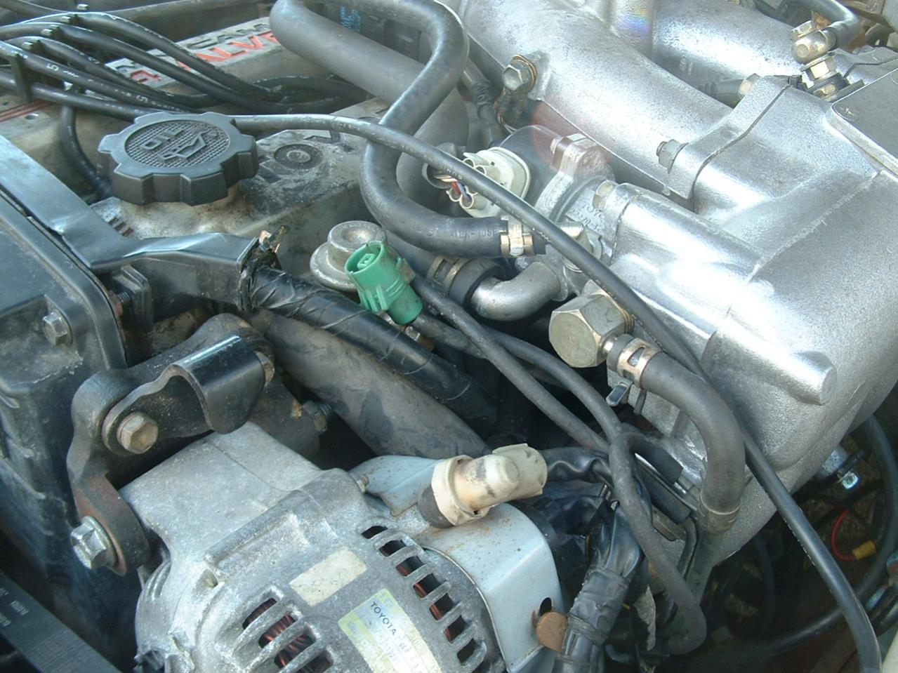

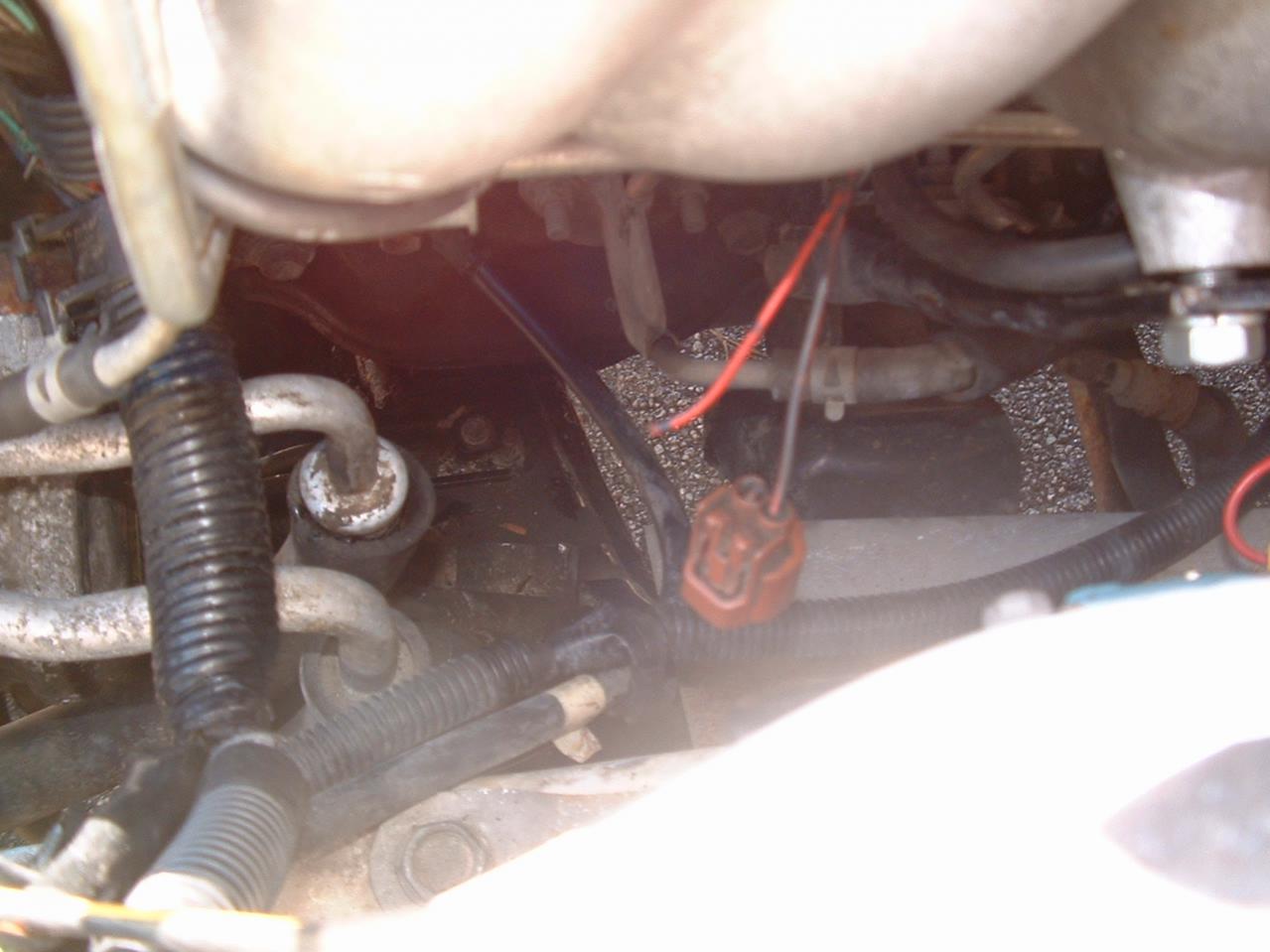

There is a broken wire on one of the connectors, VSV I think the filter is broke of it and now there isn't a bit of wire to repair the connector.
As far as the broken wire, I was thinking that I could take a straight pin and connected the wire and connector using the pin in the center and solder the area. Sounds pretty cheap, I haven't figured out how to push the remaining wire out of the connector and go at it that way. I am open to suggestions, please.
thanks

IIRC one of those vsv's is to do with fuel pressure & should really be connected, it's possible the whole thing is u/s if the filter is broken off so I'd try find a replacement if possible. As for the broken wire I can't see exactly how it's broken but if it's inside the plug as I'm thinking I'd just shave the side off the plug & solder the wire back onto the exposed connector. Try that first off & see if that improves things.

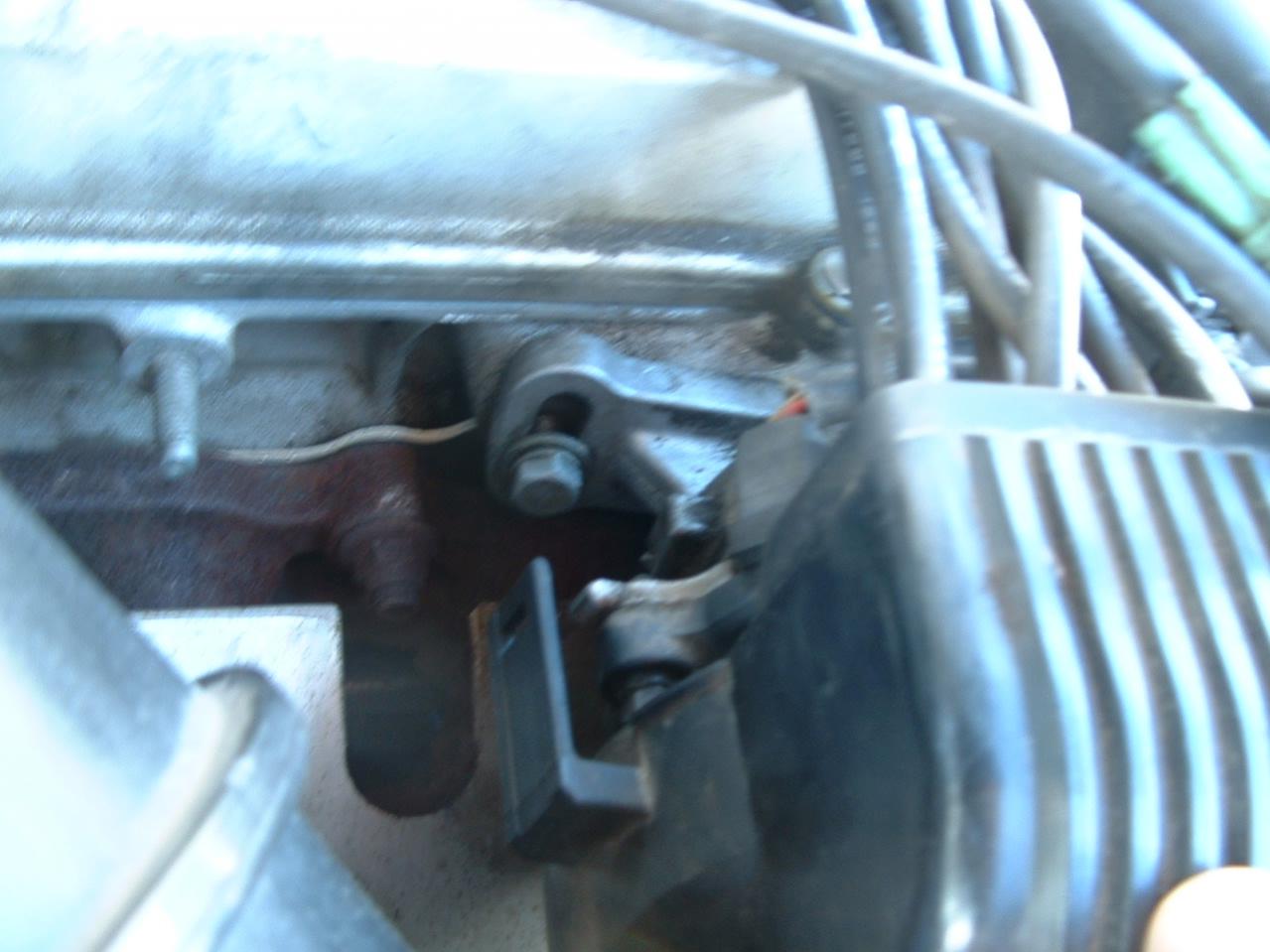

The wire is broken off flush with the back edge of the connector on the harness side.
I think getting this ACIS system working first may take care of most of the running issues.

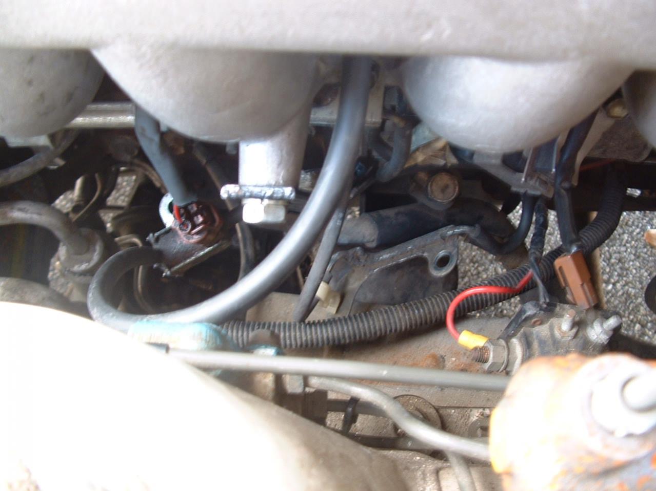

I found a connector at the junk yard for $5. Nice. So the car idles much better but still will not pull under hard acceleration. Roll out of it a little and it feels as though the motor adds a cylinder and pulls smooth. It seems to get better as it gets hotter, not good, just better. I did the vacuum test from the manual and I have vacuum when I shouldn't or don't have it when I should.
