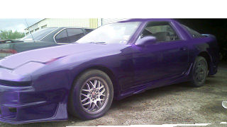

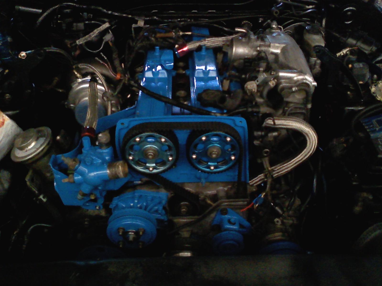

Hey Bro, just stick withe 7MGTE ! the 2JZ aint shit in comparison.
The stock Bottom end on 7M is capable of up to 1000 Hp.
Now, Ive dumped a but load of money in mine but I compete in Drift events with mine. check out the profile pics," newbie but sweet ride" in the show and tell section.
