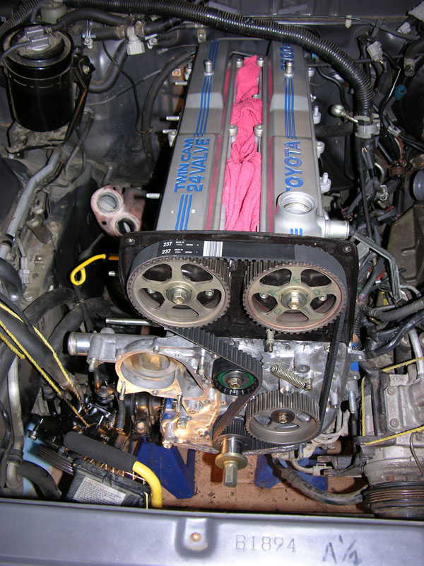

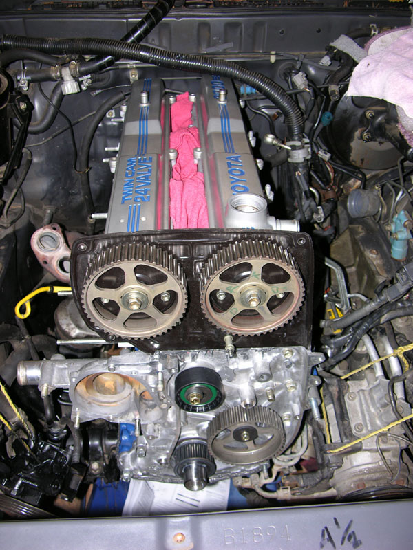

Installing the timing belt on a Supra is much easier then a 4-Runner. The manual says to install the crank sprocket, lower timing cover and crank damper in order to see where TDC for number one cylinder is but I preferred to get the belt on and set up the timing with them off so I can see what is going on.

Turns out that on the 90 Supra, all the marks are at 12 O’clock. Set both cam sprockets to 12 o’clock and the tab on the crank to 12 o’clock and you have it right.
Wrap the belt around the crank sprocket and up to the left around the oil pump sprocket, pull tight, then around both cams and the idler pulley. Double check the marks again because they will move as the belt goes on. I had to do this three times till they were correct. Now put the spring on the idler and give the crank a few spins to see if the marks still line up. Tighten the idler bolt to 35 ft-pounds and spin the crank again. Loosen the idler bolt, wedge a large screw driver in to tighten up the belt tension and retourque the idler bolt and your done.

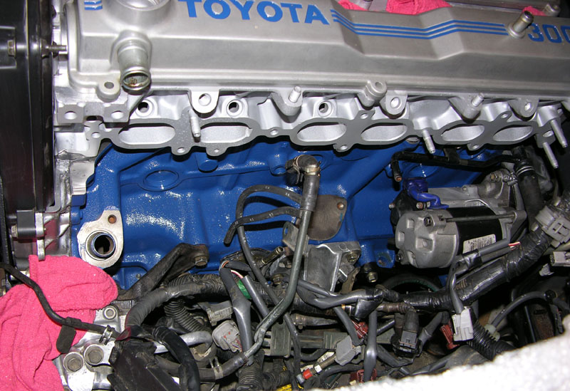

Before I put the top timing cover on, I installed the distributor to get it set to Number 1 spark since I had the engine at TDC on the compression stroke.

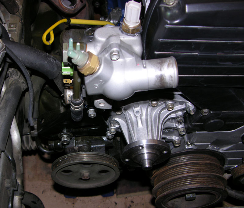

Water pump went on next and I’m making progress.

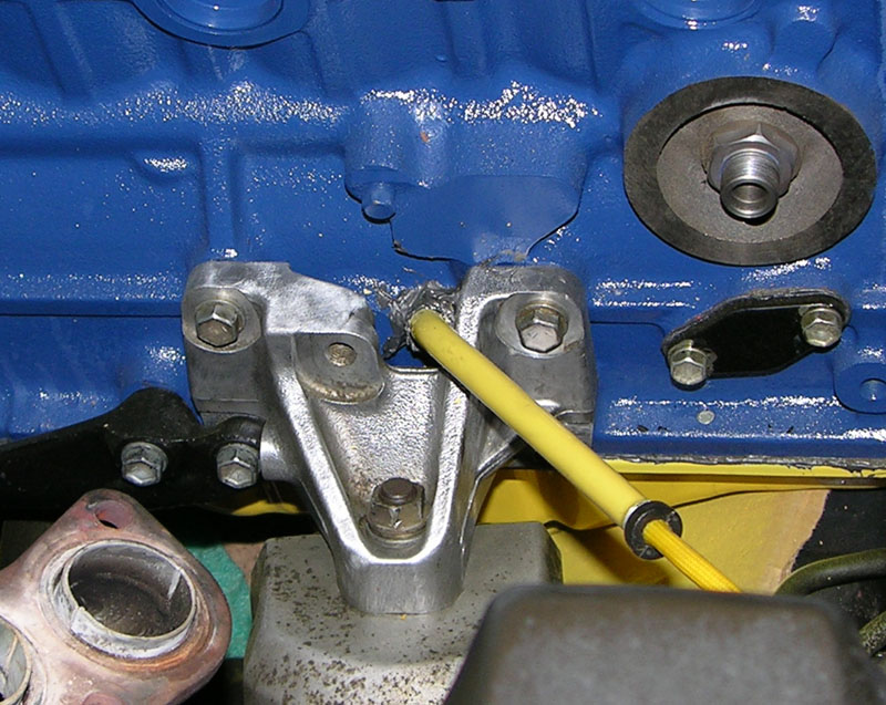

I agree, the turbo dipstick is different then the NA. The turbo appears to come in 2 parts and is press fit into Block? With a bracket to keep it from moving in or out so all you need is a O ring?
However, from this close-up of my NA dipstick –
it does not have any threads and does not have any way to be secured. It inserts to the second level but still fits pretty loose and moves around even with a good amount of RTV. So I am wondering is there is some other type of adhesive I should be using here as RTV alone can not keep it secured.

When I pulled it out - it was in there very tight.

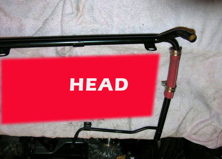

Ran into my first major mistake on the reassembly so far. I thought I could fit this U shape water pipe around the block and firewall with the head ON – NOPE! CAN”T BE DONE.
I am not going to take the head off after the 4+ hours in getting it on.
SO I cut the pipe in part that fits behind the head and put a piece of hose and clamps. Still pretty hard to secure the clamps behind the head but was only 30 minutes and not a head removal.

I point this out so anyone can know – install the water pipe before the head - it will be a lot easier.

Putting together the Water manifold was straight forward. The various temp senders could only go in one location. Be careful to start both connection hoses before you slide the housing on the studs or you will not get them on afterwards and have to take it off and start over.

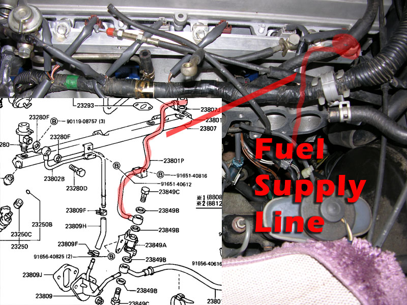

Before installing the Intake runner, you will need to route several lines through the runners BEFORE placing the intake on the head. Run the supply and return fuel lines, IAC Hose from the manifold, and water bypass hose through the runner.
