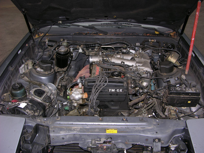

Fast forward on progress to where I am at now.

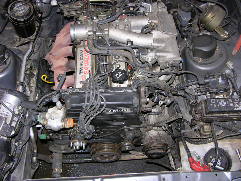

From my experiences with the 4Runners, I started by removing the radiator and fans. This gives me better access from the start.
Attachment 2207

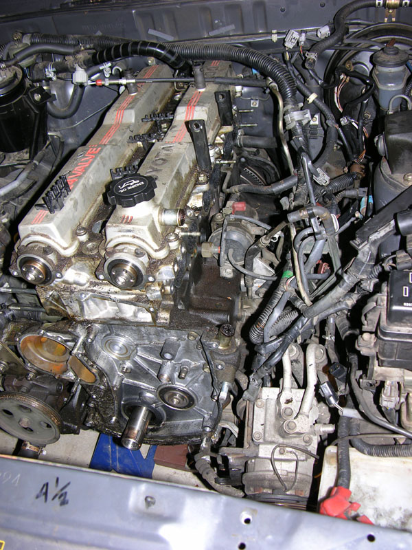

The top part of the timing cover comes off and the belt looks a little worn but not bad for 20 years. It will get replaced along with the idler
Attachment 2209

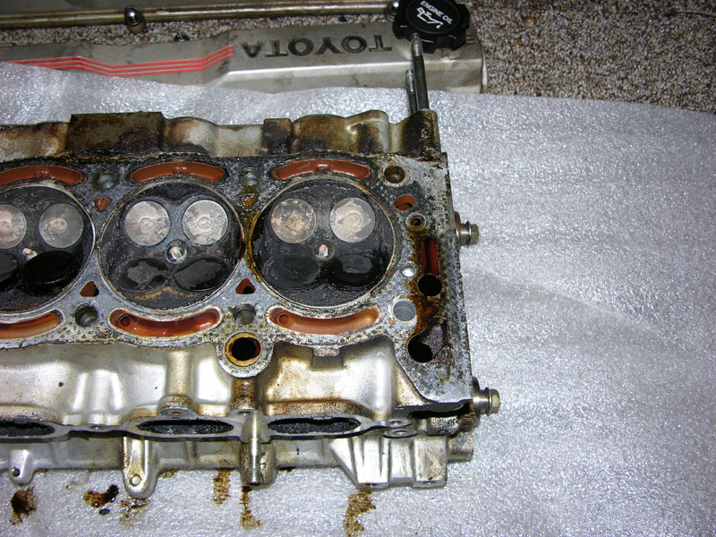

After removing head noticed coolant in the number 2 head bolt hole – not good. After cleaning the hole further looks like a crack in the threads of the hole to the water jacket. Going to have to remove engine and take block to machine shop to have it checked. I am thinking of going to studs and sealant in the bolt hole may work.
Attachment 2215

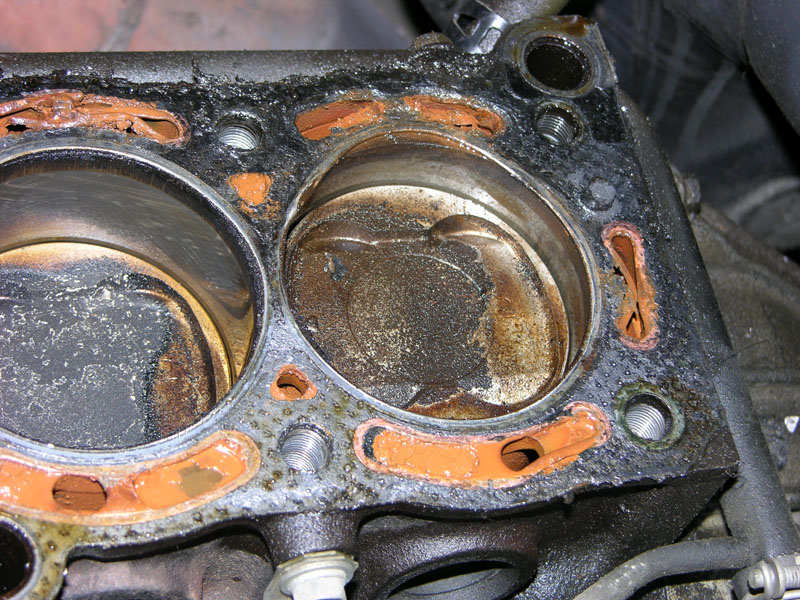

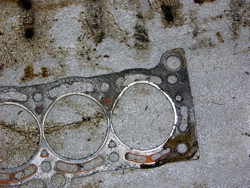

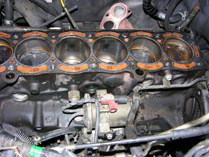

The Number 6 cylinder defiantly had a leak between the water ports and cylinder. The valves were reddish brown while all the other cylinders were whitish tan. The other cylinders were clean an shiny while number 6 has been burning water for a while. The head gasket has a significant oval shape extending to the water jacket – YUP BLOWN GASKET.
Attachment 2217
I was surprised to see how clean the other cylinders looked after 20 years. I will have the shop check out the block but looks like all it need is some cleaning an a hone to be good as new.
Attachment 2214

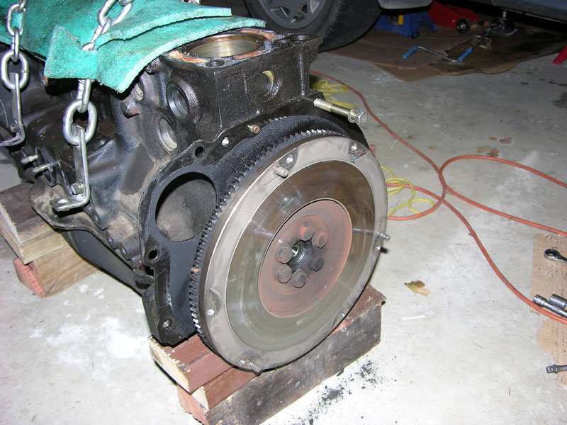

Now I get to look at the clutch and flywheel. Going to need some resurfacing and the clutch disk was worn to the bone – time to replace along with the throw out bearing and pilot bearing
Attachment 2219

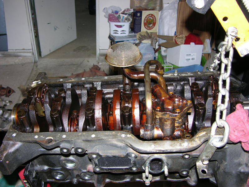

Got the engine on the stand and upside down to remove the oil pump. After unbolting one bolt it would not budge so I removed the pump drive shaft still not budge. Figured was a pressure fit so used a screw driver on the block to pry it off.
Attachment 2220

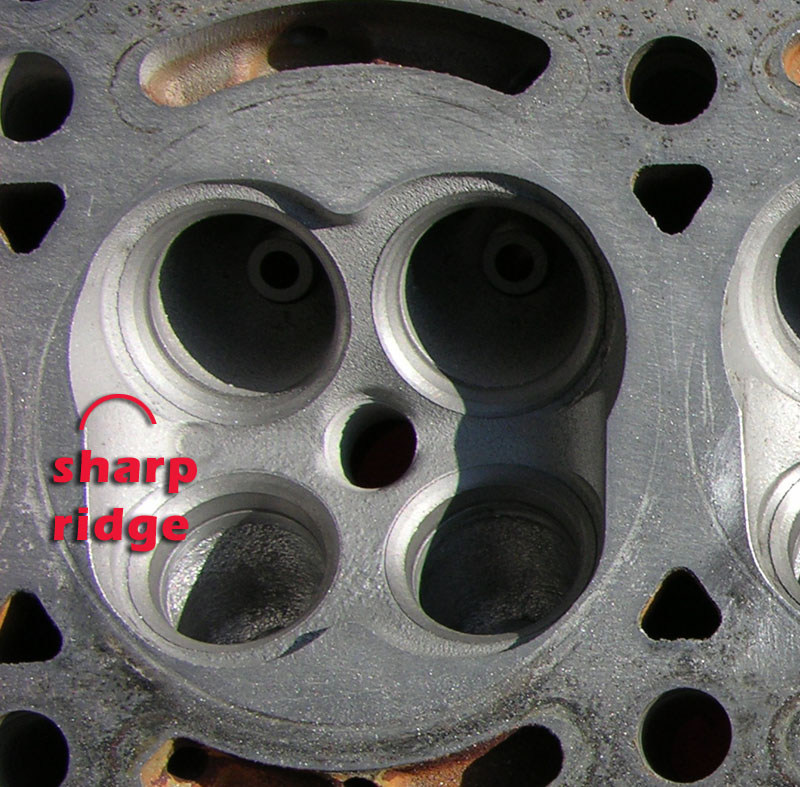

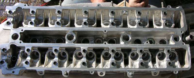

So – I took the head back to do a little porting and polish. The head had some casting marks and ridges from 20 years ago. Since I bought the car I have learned a thing or two about engines. One of which is that they are massed produced from casting molds. These molds are not all created equal and there can many flaws that are left as is in production. Some flaws include sharp ridges from casting seams and defects in the individual molds. Other are sharp angles from the machining process after the castings are poured. In production - they are all ignored.
Attachment 2255
The cylinder chambers in the head have some sharp edges that can collect heat and cause preignition so I ground them off to smooth the transitions out the valve ports. Careful to not touch the valve seats.
Attachment 2256
I focused on the exhaust ports and smoothed out the walls and take out any burrs and casting ridges. Just a little touch up on the intake side to remove any large defects as I understand its better to leave the “sandpaper” effect on the walls.
Attachment 2257

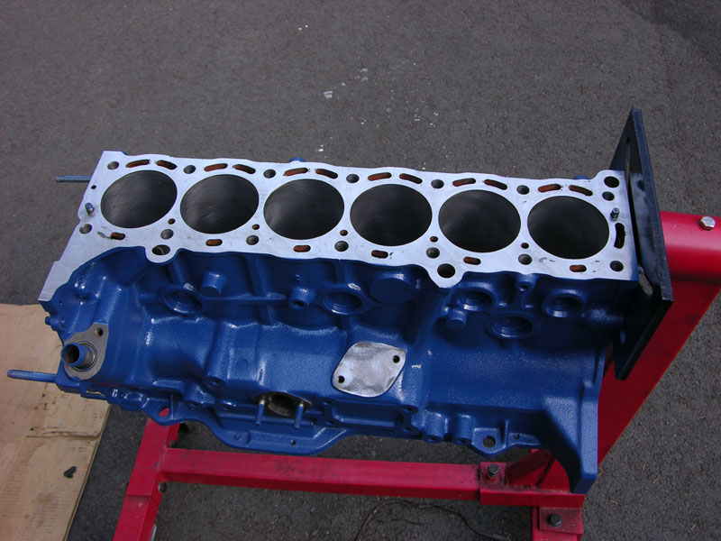

After a week in the machine shop – finally got my block back.
Attachment 2258

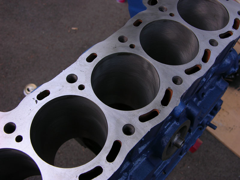

Tests showed no cracks so that’s good. The head gasket had been leaking water for some time so there was a lot of pitting around the water ports. The shop had to plane the block surface to remove most of the defects and prepare for the new gasket.
Attachment 2259
Cylinders only needed a hone to bring them back into shape.

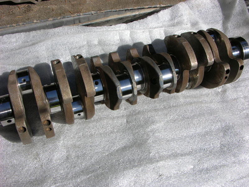

While it was in the shop – I cleaned up the pistons and timing cover parts. The Crank Shaft just needed a little polish to restore as new so now I’m ready to start the rebuild on the block.

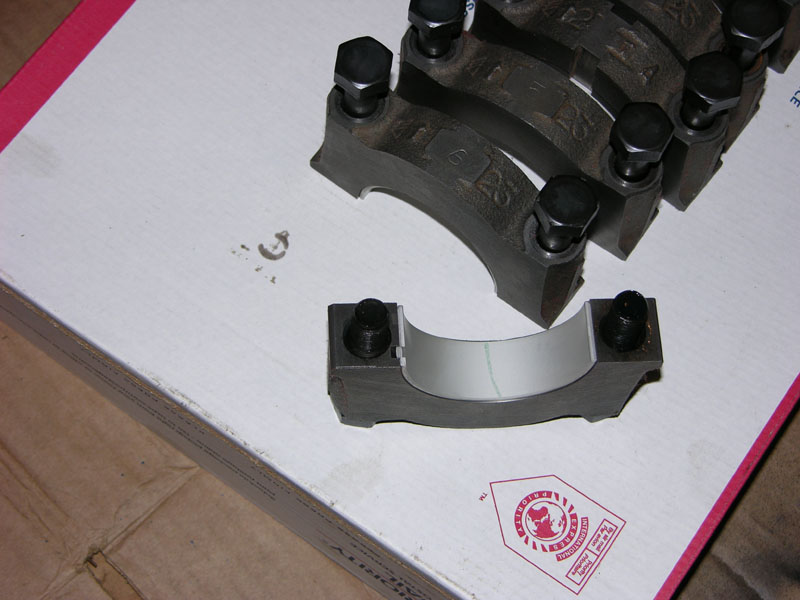

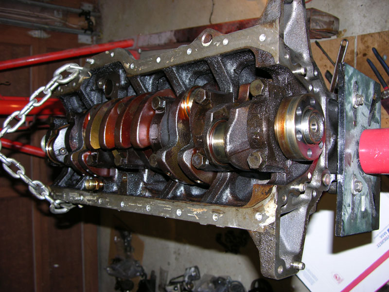

Assembled the crank and pistons into block. Laid the crank in on the new dry bearings and placed a piece of plasticgauge on the bearing face.
Attachment 2293
Torque the main caps to crush the gauge and then removed the caps. Check tolerance was OK (0.022) then cleaned and reassembled again.
Attachment 2294
Takes awhile to do it twice but felt better to know everything was in spec after 20 years. After the crank was bolted in the second time, it spun with very little effort – smooth as silk with all that assembly lube.

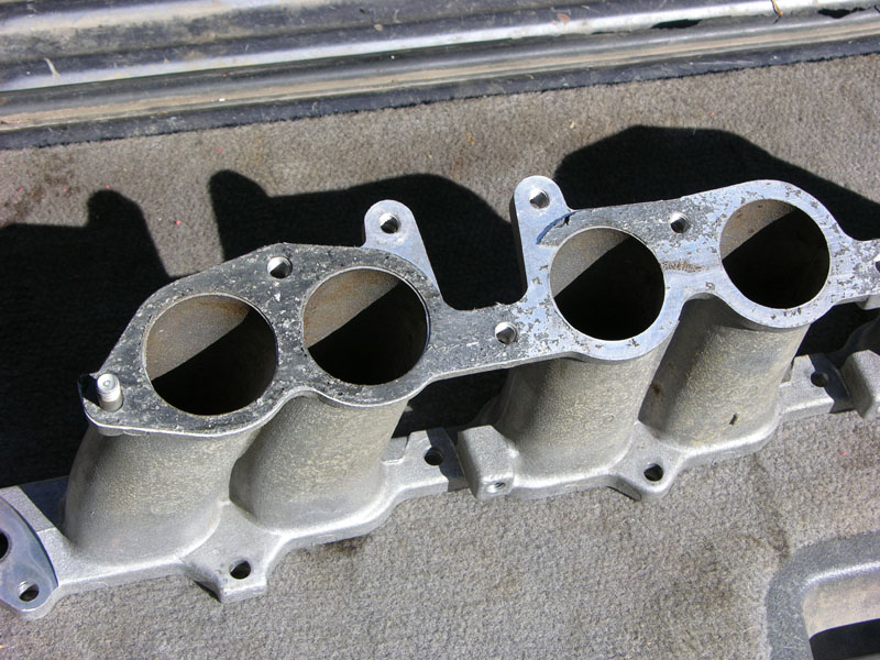

Still waiting for head and clutch to arrive so all I can do now is clean parts. The biggest cleaning job is the intake manifolds as they are clogged with residue from the smog stuff. PVC and EGT just destroy all the air passages. The throttle body took 2 days to soak off the layer of tar. Sure will be nice to get this engine to breathe again.

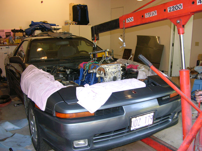

Now it was time to chain up the block and lift it back into the car. I am dong the block with out the head because it’s easier to move around and get in a do the bell housing bolts without the head on. I was concerned about alignment with the transmission shaft as it seemed real easy to snap it off if things were not aligned right when lifting the block back in.
Attachment 2331
Now – a few things I learned. First, put the two top bell housing bolts in before doing anything. I found it impossible to get them in after the transmission was jacked up to the firewall which you need to do to get the right angle to join with the block. Second, jack up the transmission all the way to the firewall to get a better angle. When you lift the block in, the front of the engine is about 30 degrees up from the rear so the oil pan can clear the lower support beams. Here is the important part – unbolt the clutch slave cylinder from the bell housing so the clutch fork is able to completely retract. It took me almost 2 hours in trying to match the block and transmission and not getting them together until I realized the clutch fork/throwout bearing was trying to engage the pressure plate that no mere human can push against. Disconnecting the slave cylinder allowed the clutch to slide in over the shaft with no pressure – SIMPLE.
Attachment 2332
