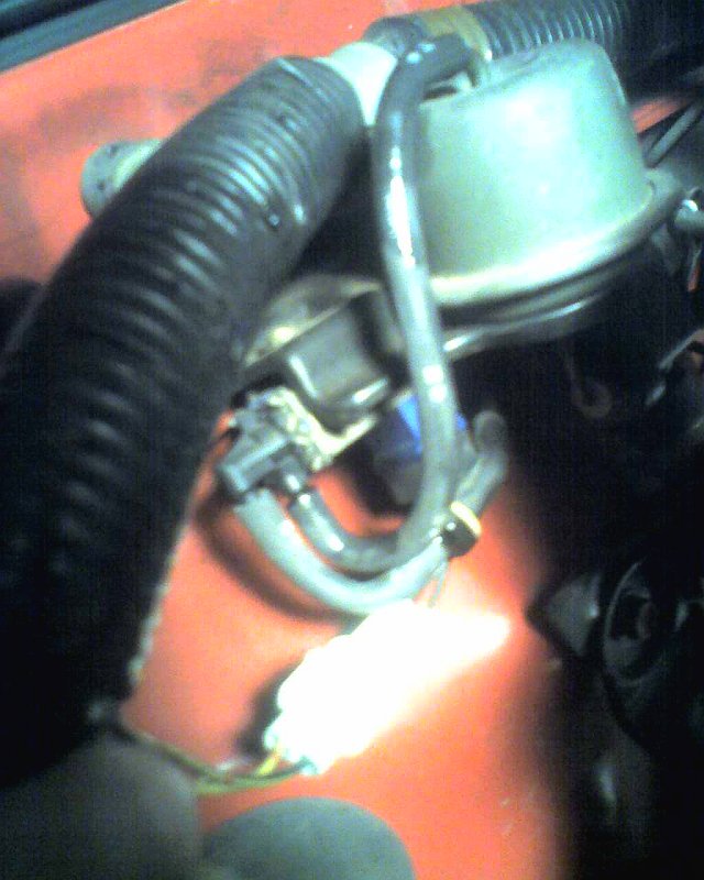

Heater Control Valve Vacuum Switching Valve - HCV VSV
This little gem is mounted to the passenger side of the firewall (I assume that's correct for LHD vehicles as it is for RHD). The control assembly is mounted above and is easily recognized by the metal diaphragm can or bell which sits atop a VSV (see pictures below). Failure of the HCV itself is uncommon; Often the failure is the VSV. Diagnosis is simple:
1) Turn off the car and make sure the A/C is OFF.
2) Look at the HCV and not the location of the valve's control armature.
3) Turn the car on (or better yet have someone do it for you and check the armature's position again. If it hasn't moved and the engine is cool enough (don't burn yourself) you may try to move it manually... I recommend you do this with the engine OFF.
4) If the valve can be opened manually but does not open when the engine is running then you may try the VSV bypass described below.

HCV VSV bypass:
HCV VSV and Diaphragm (stock and bypassed):
Name:	Heater core vsv stock.jpg
ID:	4485 Click image for larger version
Name:	Heater core vsv bypassed.jpg
