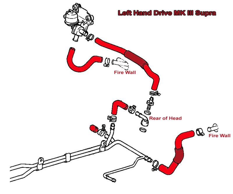

Heater Control Valve and coolant routing:
Attachment 4483
