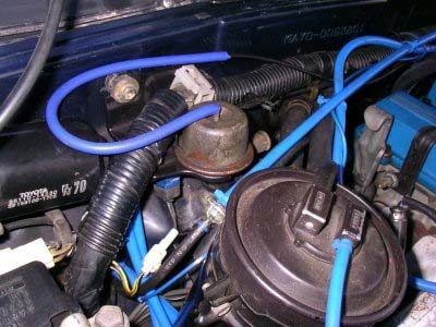

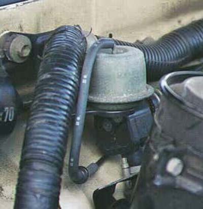

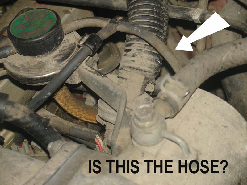

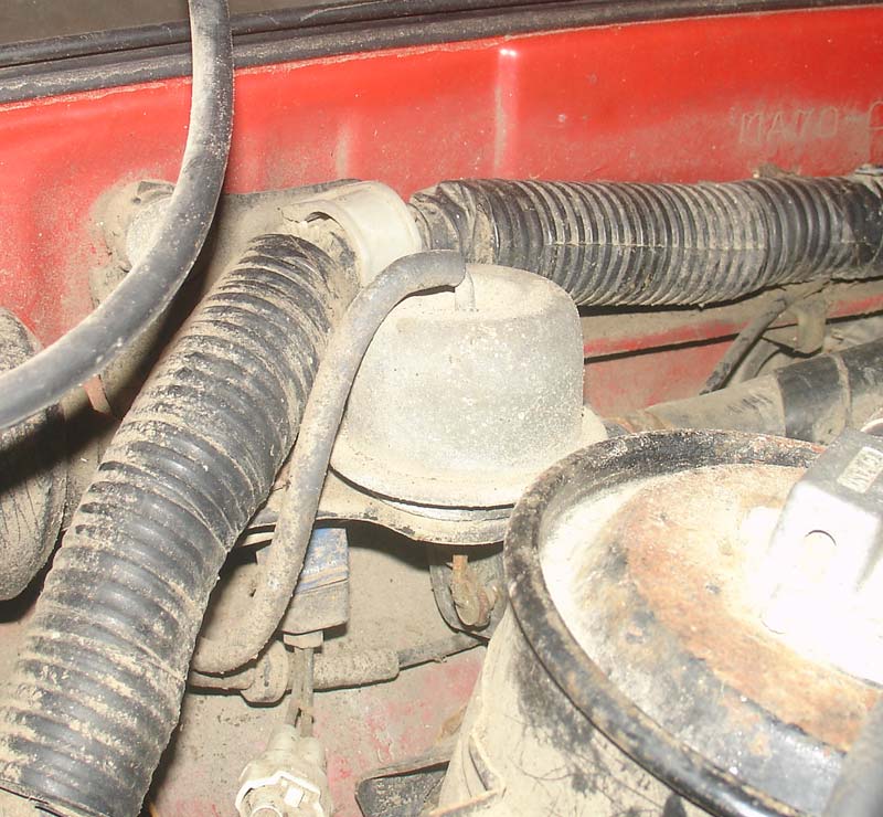

I would like to try this bypass but my car is an NA, I have no heat in my car. I looked at the link and then looked at my car. Here are a couple of pics, is the line in the second pic the one you connect to the top of the VSV and if so what do you do about the hole left where it was connected or do you T it off?
Please explain exactly what is done better than the person that made that post. Thanks, Scott
They appear to be using different lines in these two pics from two different posts to make the bypass.

I fixed mine. it turned out to be a problem with the heater control valve. i did the same thing they did on the picture with the blue vaccum lines. i used a T connector on a vacumm line on the driver side of the engine bay( cant remember exactly which one i sold the car) and used the extra port opened up by the T connector to run a vacumm line across the fire wall to the heater control valve. any vacumm line anywhere on the motor will work as long as its a constant vacumm. this will keep the valve open so there is always coolent running into the heater core therefore the heat is always ready for you when you hit the heat switch to open the door on the heater box.
