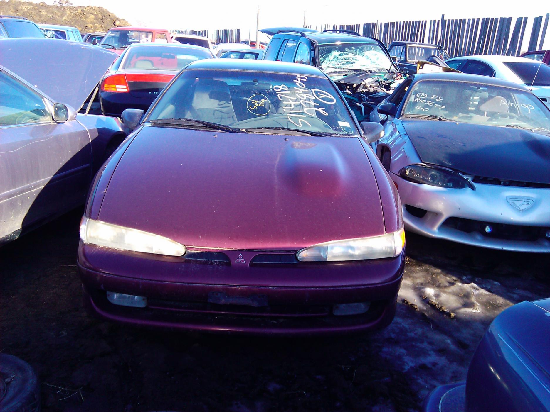

Well little bit of an update, winters here and all I've basically got done is the hood primed and ready for repainting, and new wiper linkages that have yet to go in. Its 25 below here so my work is done for awhile seeing as I dont have a garage to work in. Hopefully be getting new stainless steel slotted rotors for Christmas just have to go back to the local shop and decide which ones I want. Found out my head gasket or head might be fucked, lots of moister coming out around the head and steam so I'll be looking at a new head gasket at the lest and my hatch is completely toasted rusted right through on the inside in several places so I some how need to afford a new hatch along with a full body paint after I tear her right down, plus hopefully only a head gasket. Another thing is I bought a 92 eclipse just this weekend for a steal from an auto wrecker, I'm a huge DSM fan so I'll be working on it first just needs a couple things and it'll be my DD till I fix my supra then the supra will be the DD and I'll be doing a rebuild on the Eclipse, if I can get all the parts I'll be swapping the 4G63 n/t for a 4G63 turbo set up which will give me (when I'm done) roughly 240whp (will get the head ported and polished, can also get a good aftermarket head gasket with upgraded 450cc injectors and a walbro 190lp) from the 135whp I have now; that's only if I can get a good turbo tranny from a GST model. The reason I'm putting the supra on hold is because the Eclipse is going to be the fastest build right now, I hope you guys aren't to mad. The supra will be worked on just not for awhile sadly. :-( I'll keep popping in from time to time to see whats up and if you guys want to still know how its going then I'll update here as well as on DSMtuners.com. Thanks for all of your guys get advise and wisdom I'll still need it and am always looking for more.
mechrider89 12-08-2011 04:26 AM
2 Attachment(s)
The Eclipse I bought
Attachment 4416
Attachment 4417
87hilux7mge 12-08-2011 10:23 AM
still interested myself in the supra build, and cant blame ya for pickin up an eclipse. been seriously lookin at gettin a gsx myself, just for shits n giggles.
i thought the 1g eclipse N/A motor was a 4g37? ive seen a few n/a 4g63's, but in 2g's. idk, shows how far my knowledge on dsm's is.
good luck with the build tho, driven a few GST's and they are hard to keep the tires planted in!
mechrider89 12-08-2011 12:44 PM
haha ya they are, my first DSM was a 92 talon TSI, never should have sold that car! Actually most Eclipse's/talons/lasers for the most part all came with 4G63's in them 89-93 had the 6 bolt flywheel (considered the best engine) and the 94-98 have the 7 bolt flywheels but better ECU's and turbo's for the most part, never heard of a 4G37. lol
If ya do pick up a GSX or something let me know!

87hilux7mge 12-08-2011 10:36 PM
well, just found a 91 talon tsi, 400 bux...guess i should eat my words. lol. need the motor gone through, but its a 6 bolt (skipped teeth, bent valves) and the rest of it is in great shape.
figure i can rebuild the motor for about 6-8 hundo and have a good lil car
mechrider89 12-09-2011 01:02 AM
dude if that's the cars in good shape buy it!!!!! thats a bloody steal. I got mine for $770 running and driving from a near by auto wrecker, bent valves and a head but other wise good condition car for $400 TAKE IT!
you find it online I take it? pop me a link?
Ya im not used to hearing the 4g37, but ya the 1.8l is junk.
You see the car to the right of mine in the pic's the 2G talon has a really rare factory bumper I'm going to see if its not broken and if it ain't then that'll be another $190+ in my pocket.
Oh and if you do buy it get the balance shaft eliminator kit for the engine when you rebuild it, it'll stop the timing belt from skipping on you.
here's a link:http://www.dsmparts.com/customer/pro...8&bestseller=Y
The bottom end should be fine, just take a quick peek at the pistons and if they have light marks from the valves they're fine to run again (unless the rings are shot of course). Check the head out make sure its not cracked, if not may as well send it away for port& polish. If your lucky you'll just be looking at valves and a head rebuild, in most cases its just valves that need to be replaced. keep me updated man!
87hilux7mge 12-09-2011 01:45 AM
yea, its in pretty good shape, ill upload some pics here for ya. im thinkin just do the valves and balance shaft elimination, plus a good gates racing belt. if i PnP the head, ill just do it myself. check out my album and youll see the work i did on the 7m head.
im thinkin ill just set it up close to stock. maybe to the gm maf and translator, FMIC, big 16g (or a ball bearing turbo of some kind), bigger injectors, and some differential work. some lowering springs and struts too, w/ some better tires and maybe the big brake upgrade. that all depends on how long i hold onto it.
i just want a good lil car that gets decent mileage, is fun, and can still roll in winter if i dont wanna drive the truck.

for porting and polishing i just smoothed out the short side radius, deshrouded the valves and partitioned the divider between the valves to a narrower edge.
doing that to a minimum on the 7m head netted me about 20cfm more flow on the intake and 15cfm on the exhaust. first time i ever did porting so i was happy.
i just used an electric die grinder and some dremel bits. a better setup would be a good air grinder or 1/4" electric. youll spend more money on the stuff, but itll go alot faster. add in the porting kit from standard abrasives (google standard abrasives) and thatll give you everything you need to do a full porting job.
anyway, i put some pics in my album of it. pretty stoked to pick this car up. im also pickin up a 93 mazda mx-3 with a v6 and 5 speed, 200 bux for that one and it runs great, just needs gaskets, has a steam release into one of the cylinders. i plan on fixing that one and selling it, or putting one of my extra eaton m62's on it for a fun lil hatchback.
im gettin the feeling im going a lil boost nuts...:grinking:

thanx for the info man, I might just have to get a practice head to try first just to be sure I don't butch it. lol
Looked at your talon pick and all I gotta say is GREAT FIND!!! totally jealous for sure now. .........take it off your hands for $600?? :bouncy: jk definitely be a keeper in my books that's a clean 1G, plus a good find on the mazda could pay for a lot of parts!
87hilux7mge 12-10-2011 03:52 AM
yea, the big trick with porting is use some dykem (metal dye) or a sharpie, color your surface and score your gasket faces in so you match them up well. then just go slooooow. i only spent 12 hours porting on my 7m head, but i didnt enlarge the inlet ports at all or gasket match anything, i just cleaned up the shrouds, guides and short side radius.
standard abrasives actually has a pretty good walk through on their site if i recall.
haha, believe it or not, your not the only person thats made an offer on it. i had one for 800 and one for 1200 as she sits, but i wanna keep it now that i found one for such a good deal. and yea the mazda should pay for quite a few parts i hope. like i said, if it doesnt sell, im throwing a S/C on it and swapping around mafs and injectors, tossing on a SAFC2 and seeing what happens. possibly a KLZE swap after the supercharger heh heh :bouncy:
ill make sure to keep you updated with the talon on my end, you do the same man. also, on the 5m i wanna know whats goin on with it!
