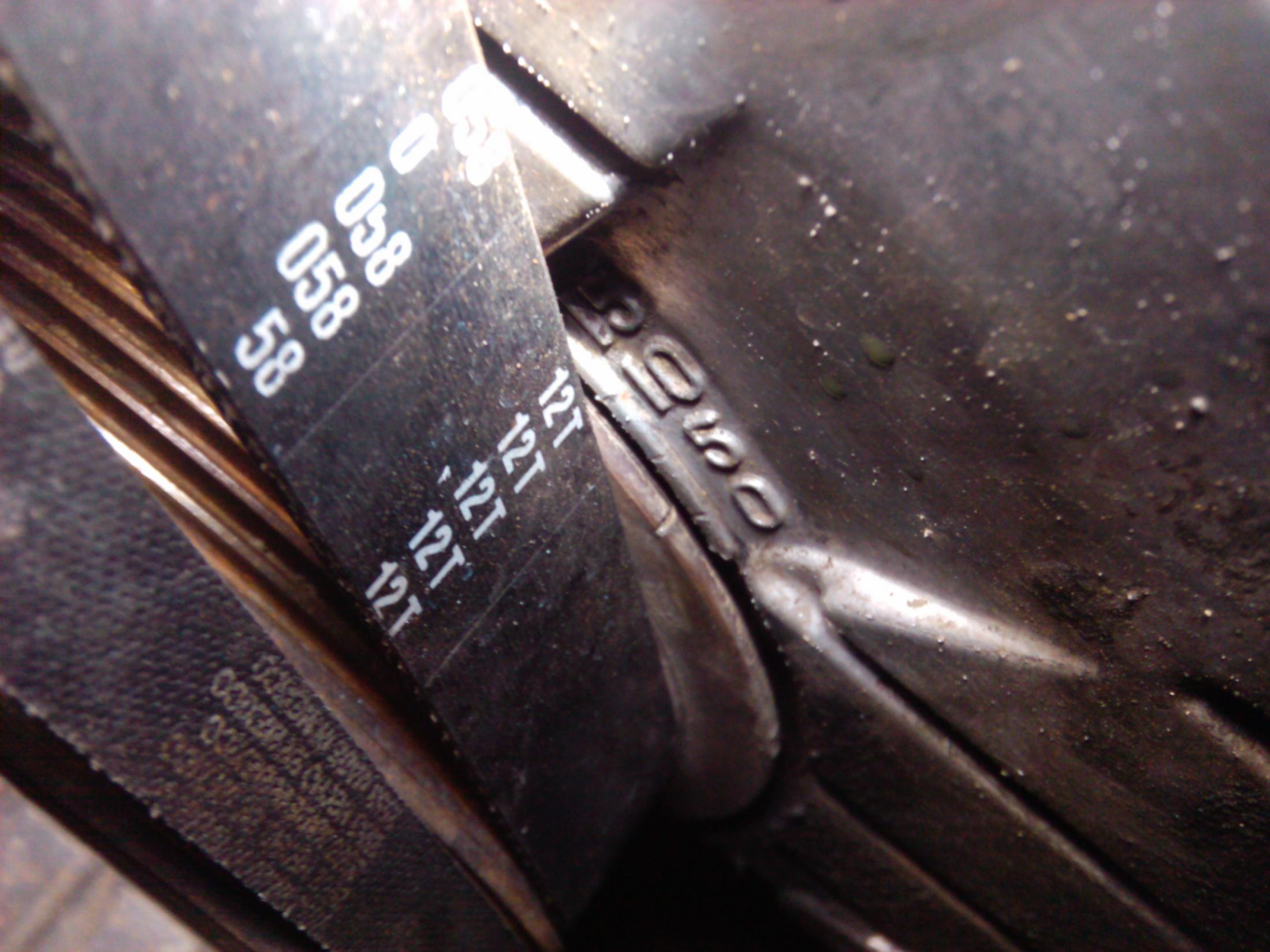

Attachment 4702
Crank timing
I pull the timing belt back off and made sure everything was perfect with its timing marks but I noticed I couldn't get the timing belt on then.

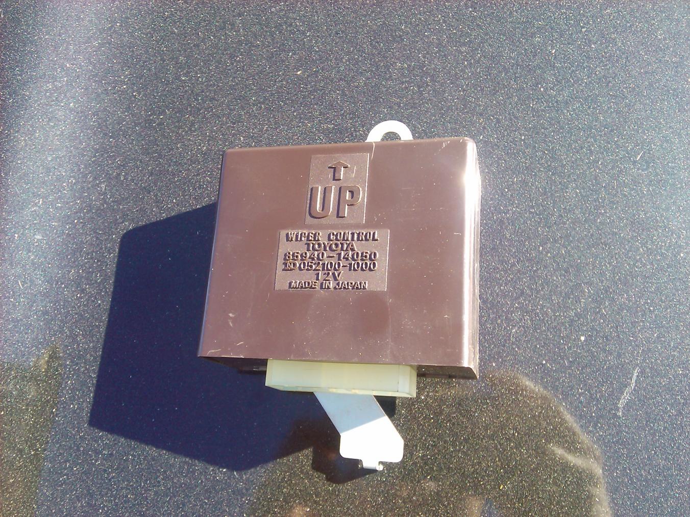

Here's a pic of the wiper control module. should be brown like this:
Attachment 4703
Its located passenger side kick panel by the door and hidden behind another yellow control module.
CanadianBak'inSupra 09-23-2012 02:17 PM
ill take a look around, but i am getting a parts supra, so if you have not gotten one by then, i will have one for you.
