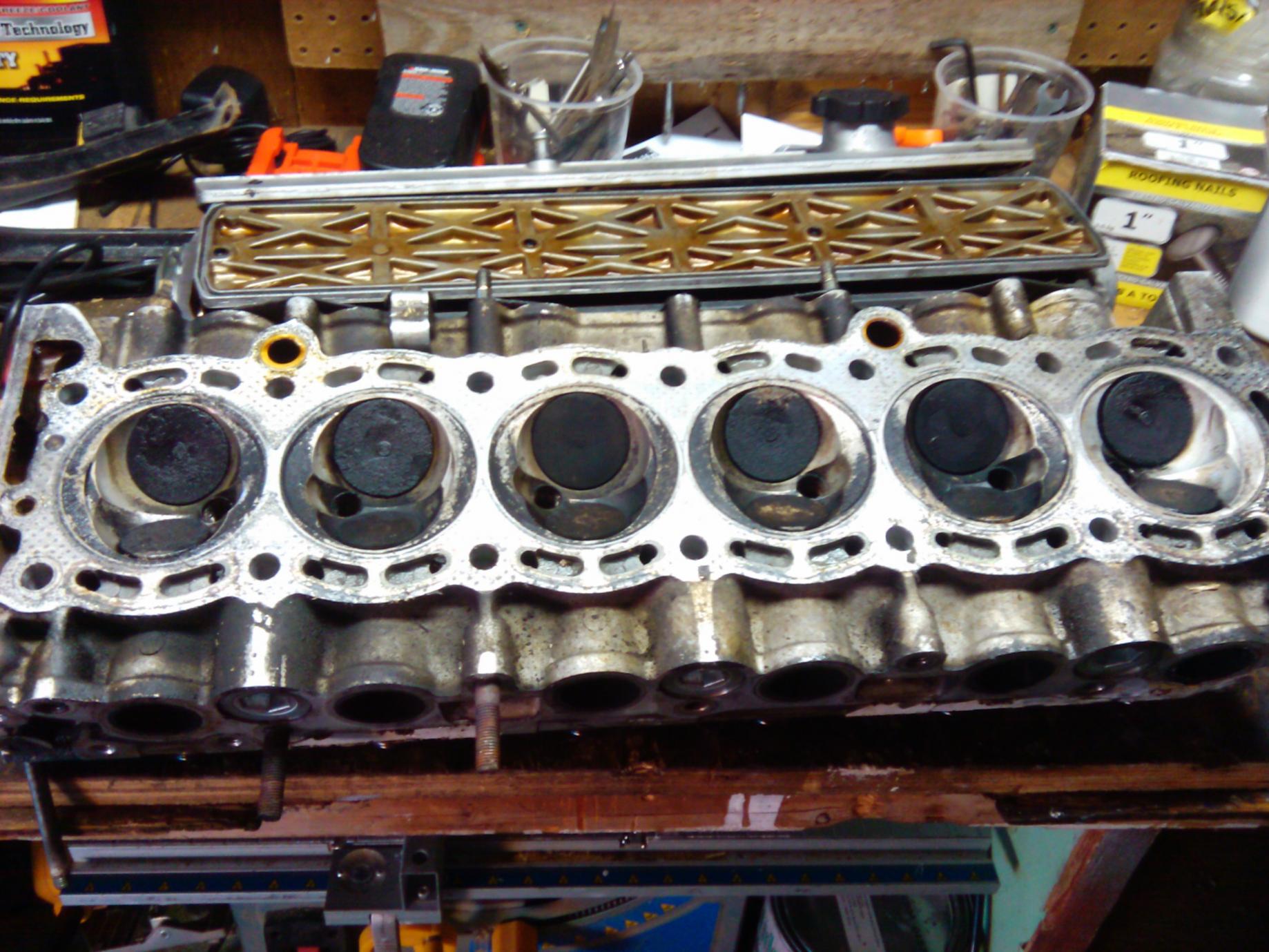

To late to take it to the machine shop today so it'll be going tomorrow instead. When I got to taking the cylinder head off it was the moment of truth for me, and boy did it go in my favor! The pistons and cylinder walls are in great shape, can still see all the cross thatching from being honed. The top end looked just as good as the bottom end as well, I feel my spirits being lifted slightly now!
Will take some pics in a bit for you guys to look at.

little before machine shop pics
Attachment 4674
Attachment 4675
all my cylinders looked like this so that's a plus

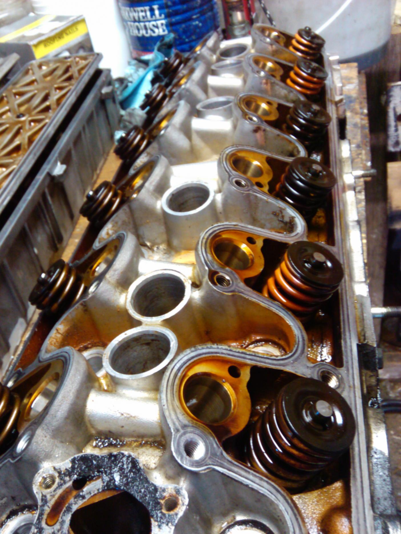

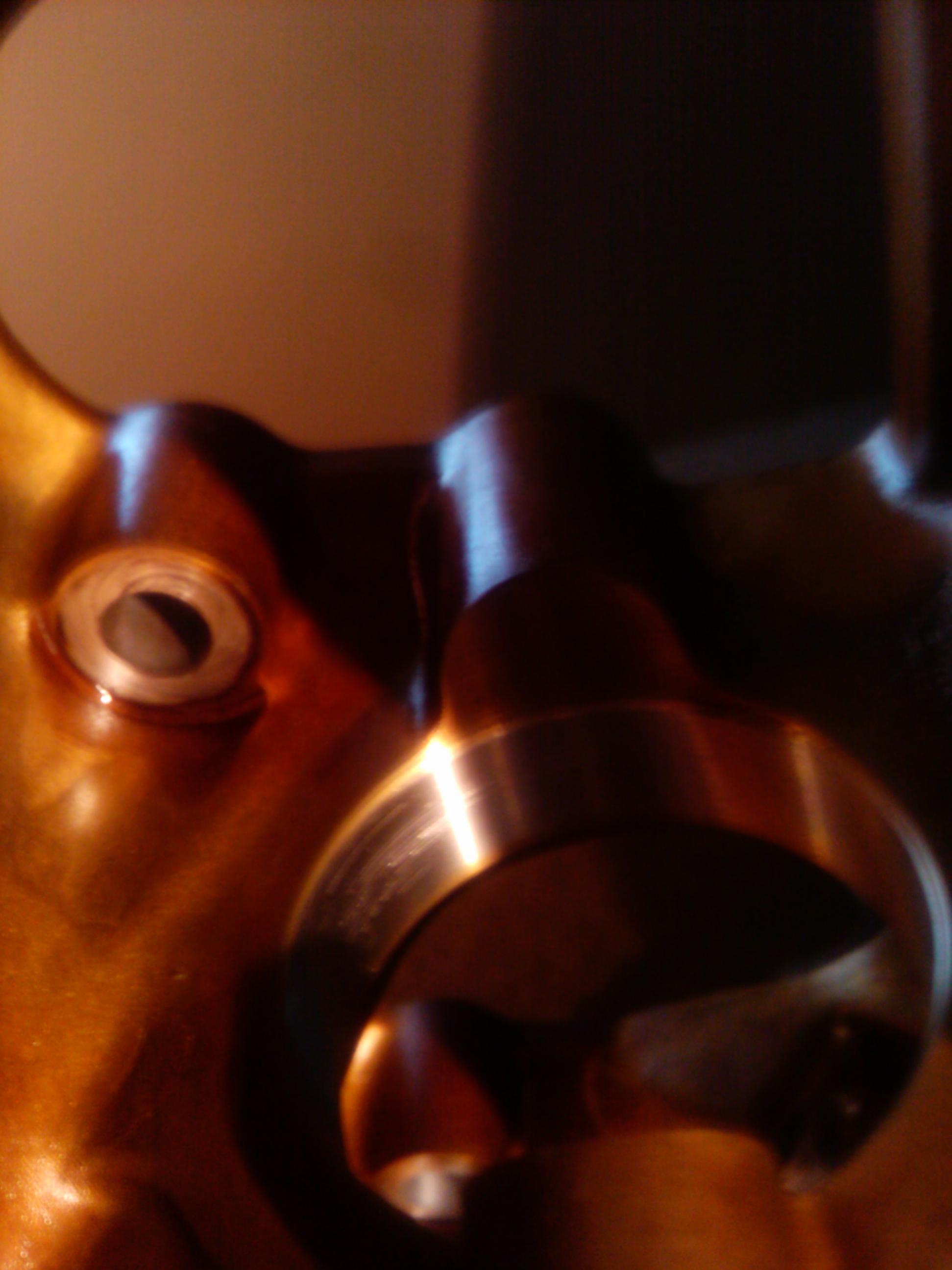

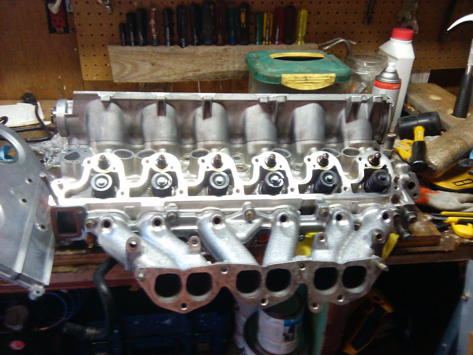

Just cleaned up parts and such today and measured my head studs, some had about 2mm stretch in them I just hope I can still use them. Also found out the whole felpro seal kit I bought is missing a lot of gaskets which is a huge let down. To add to that my cam towers need some serious machining looks like shavings got in between the cam and races in the towers, but the lobes for the rocker arms are perfect.
Attachment 4676
Worst one, felt litterly like sand paper, yet the cam wasn't to bad.

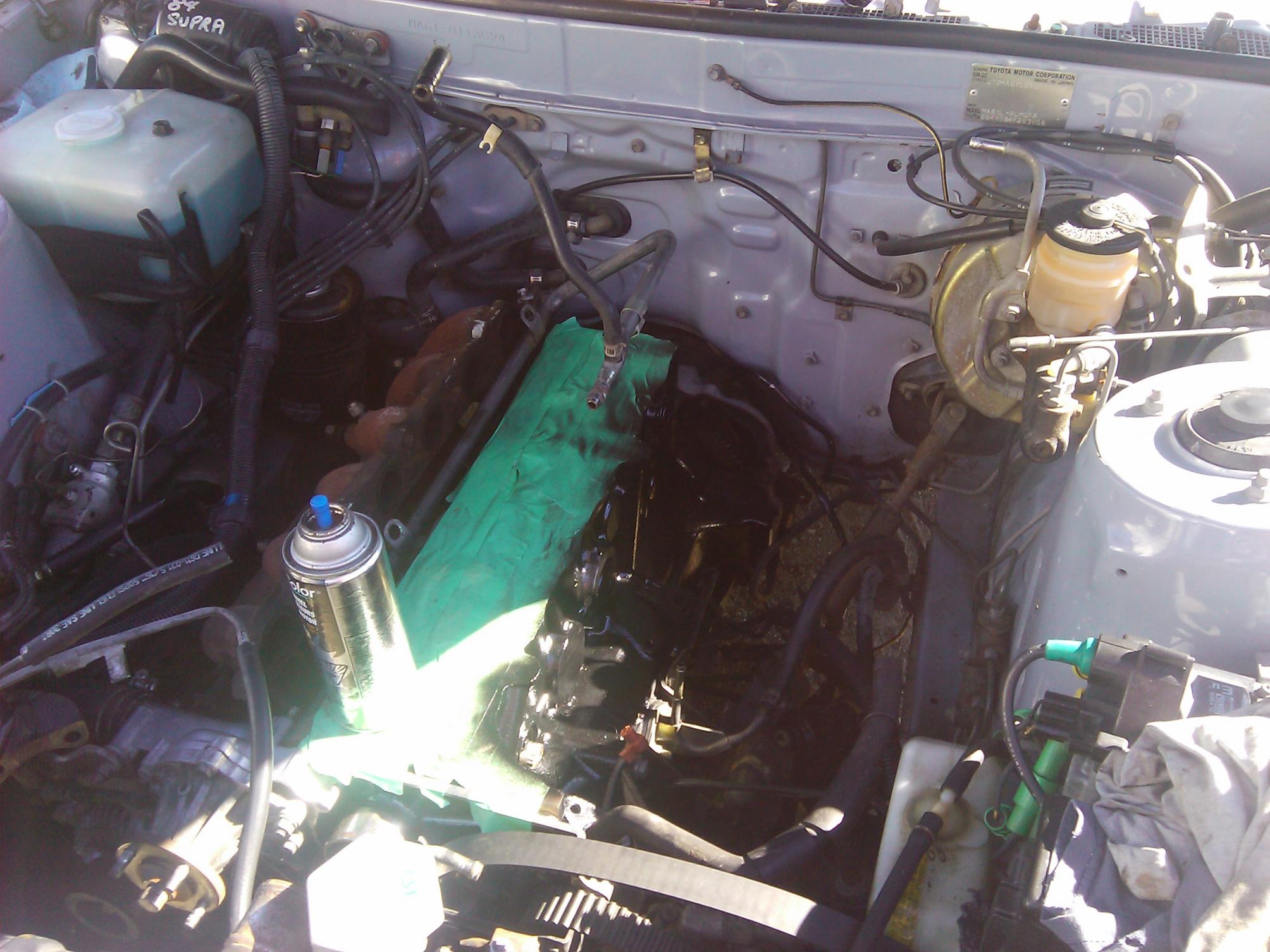

Figured well I had the top of the engine off I'd also take the time to give the block and engine bay a nice scrub (its filthy), get some before and after pics of that to.

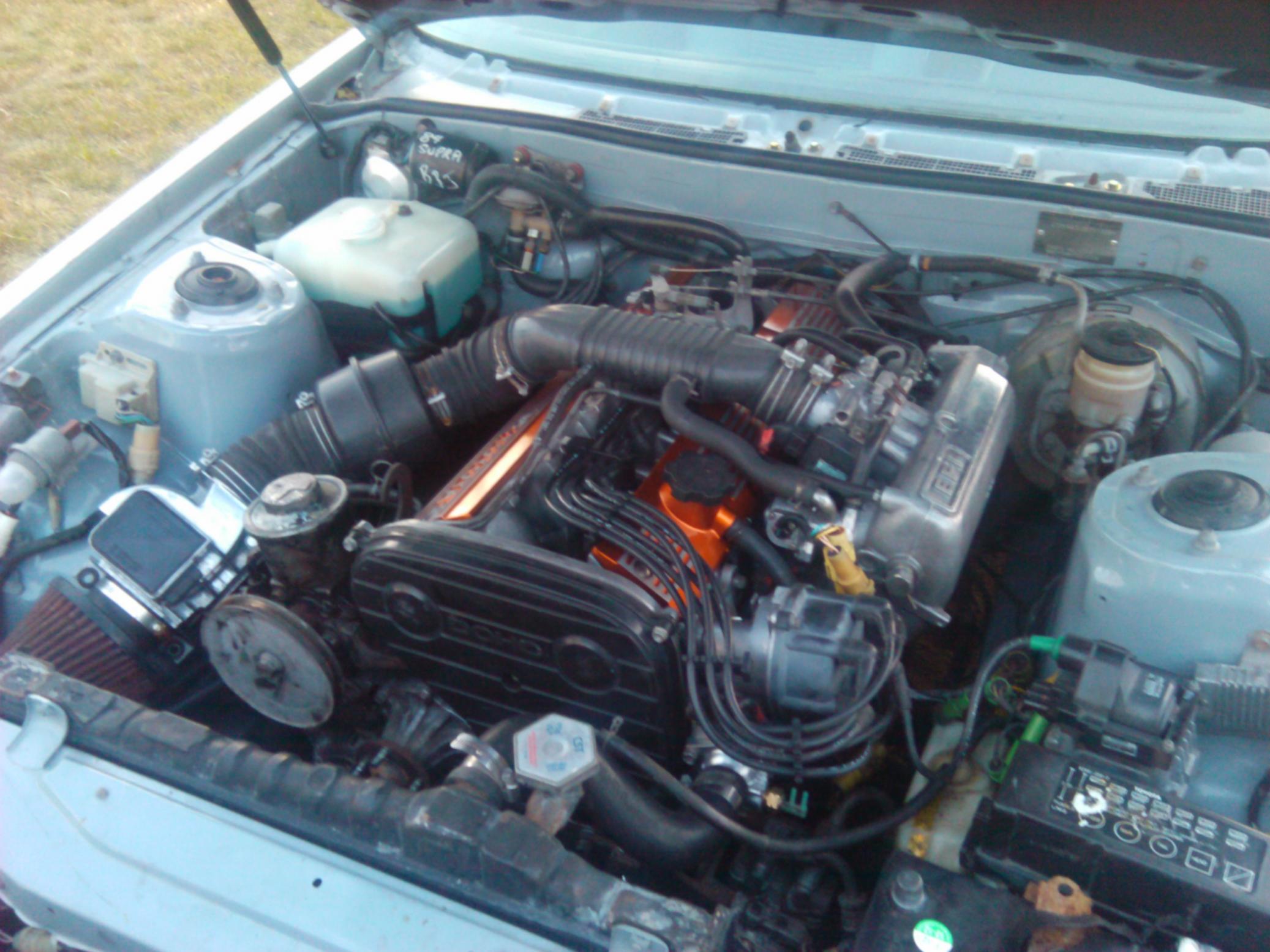

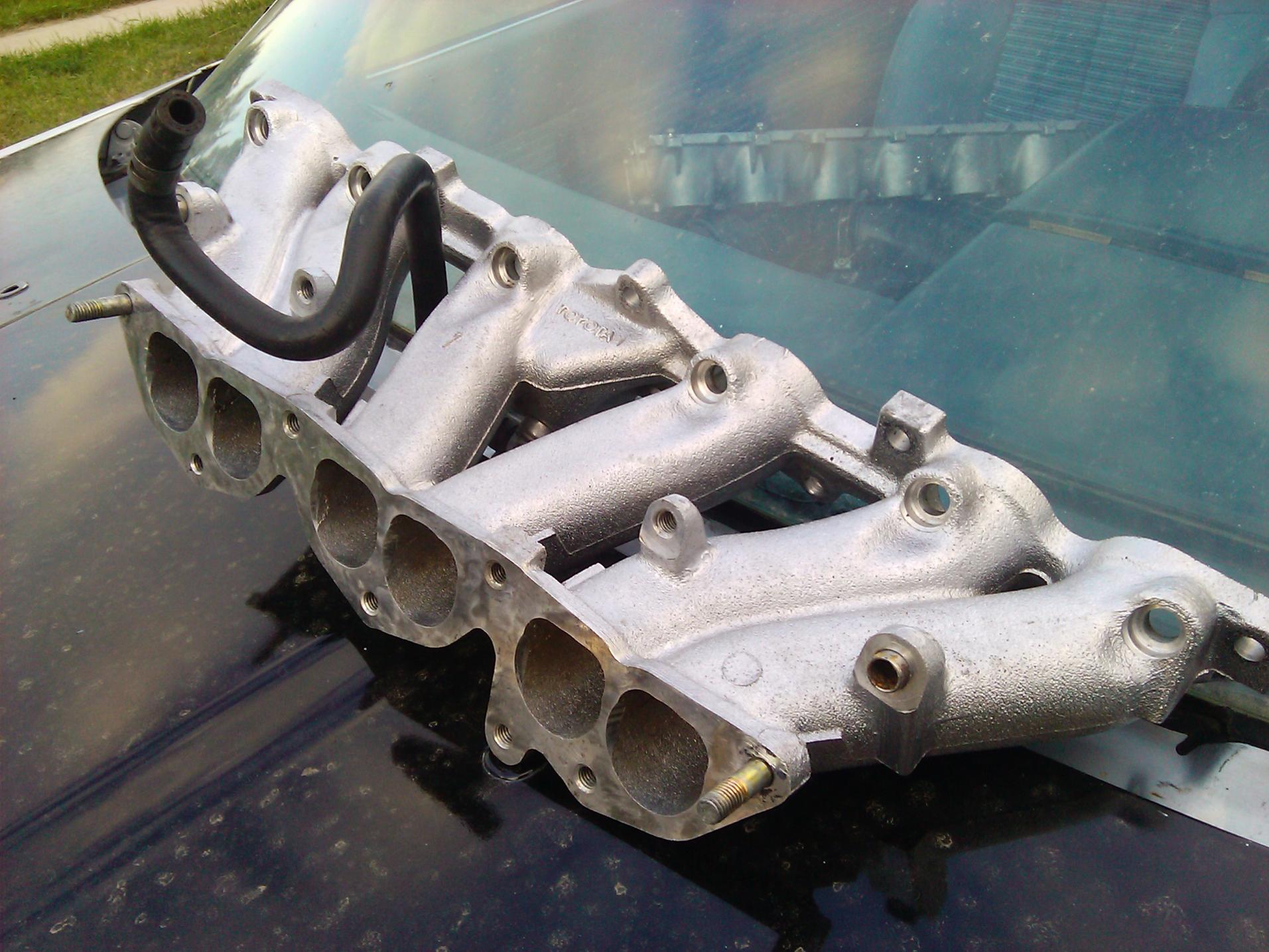

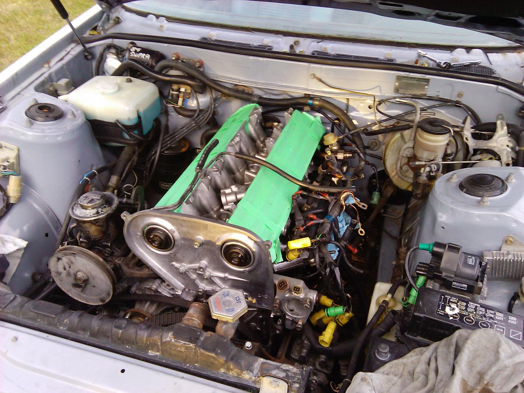

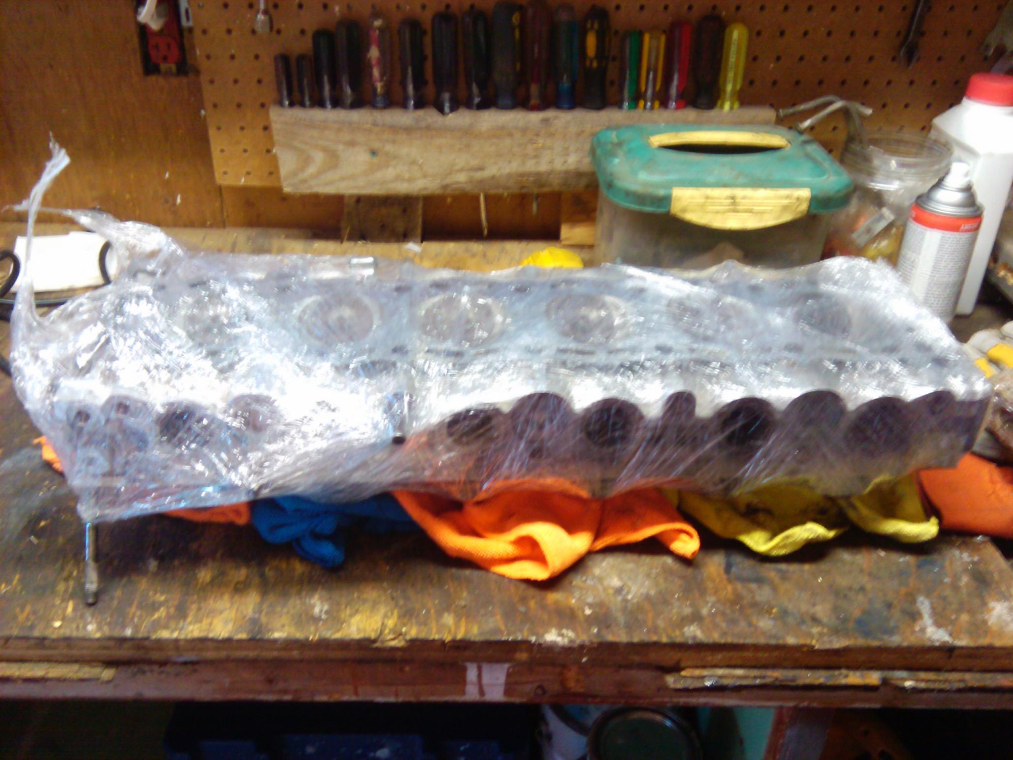

I got my head from the machine shop last weekend and was impressed with the price, it only cost $189.00. They resurfaced it a 0.006 ,cleaned it up, pressure tested it and installed new valve seals. But when I got to unwrapping my head (lol) the clean job was complete shit and still had rust, old gasket material, and carbon in the exhaust ports. So I spent and extra 2 hours cleaning it more instead of bolting it up and I was pissed off about it. Also got them to look at my cams and cam towers and they said they were in great shape. But continuing on I was waiting on parts till this monday so I couldn't really assemble much but now I'm at the home stretch. I had a little trouble timing the engine but I got it right after an hour, painted up my valve covers to (not my color of choice but its all they had) hope you guys like it. I've got everything back on and bolted up except for the oil pressure regulator, vacuum lines, accessory belts, clutch fan and shroud.
with out further ado here's the pic's:
Attachment 4692
Attachment 4693
Attachment 4694
Attachment 4695
Attachment 4696
