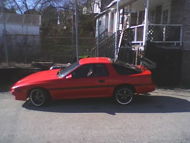

Default nice job sir
two thumbs up on the interior rebuild. lookin sweeeeetthanks for the post. i am definetly doing that will blend in nicly w/the new paint job outside
