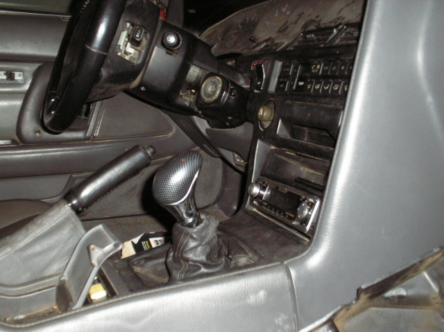

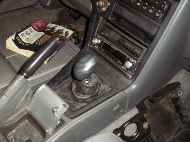

actually, i have a short throw shifter on mien and i lvoe it, it is short tho. not too short, but hsort. it really alows u to throw it into the gears, and get reallllllly fast shifts off. ill show ua pic tommroow when i can take it in the light.
