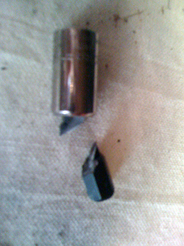

Got the head off today, #10 and #14 head bolt stripped out and took forever to loosen, hex head bolts...never again...They were pretty seized up so I wasn't surprised they stripped, actually so f'in seized up had this happened:
Guy at Sears: "I've never seen a hex bit break clean in half like that"
Me: "You're welcome..."
