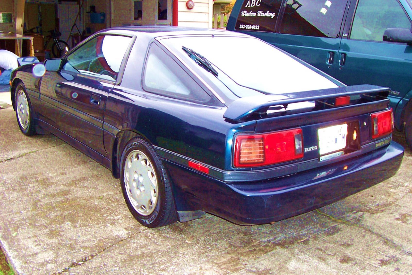

Common issue. NEED answer. I have a 1987 7mgte auto blue interior blue exterior, 150,000 miles performance short block and overhauled turbo ct26 not sure what overhauled means, but the receipt tells me so?
First of all, where can I get replacement rubber that surrounds all the glass on the hatch, the windshield, and the rear side windows?? The black rubber is peeling off of the chrome around the glass, is this weatherstripping? The chrome around the windows is ugly, and I need a solution to making the chrome around the windows black again. Thank you!
Second of all,

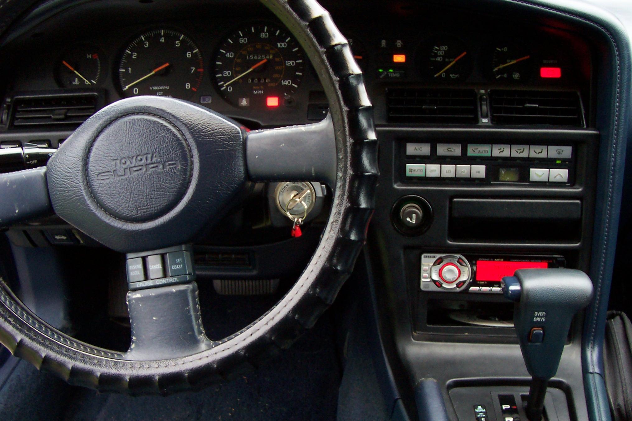

please help me, My fog light switch does not turn on. I flip the switch and there is no click sound that tells it is activating. Also, the switch does not light up when I turn the fog light switch to "on" position. Please help me figure out if this means that i only need to replace the switch. The bulbs in the fog lights themselves are brand new. Thank you!
Third,
how much will it cost for a decent paint job. Mine is blue, SHOULD I paint over the side trim molding, remove the side trim molding? How can I get the side molding trim chrome finished.???
Fourth,
Overhauled turbos. How long will it last at 6 psi if I floor it all the time?? How can I tell if it is a 57mm of 60mm CT26??? PErformance short block as well? Is it unhealthy that I have a 3 " downpipe, elbow, and then straight pipe 2.5 inch all the way back with flowmaster crooked muffler at the end? (looks pretty cool actually)? Will this burn my valves, because someone told me that straight piping will burn up my internals... ? ? That made me nervous.
Fifth,

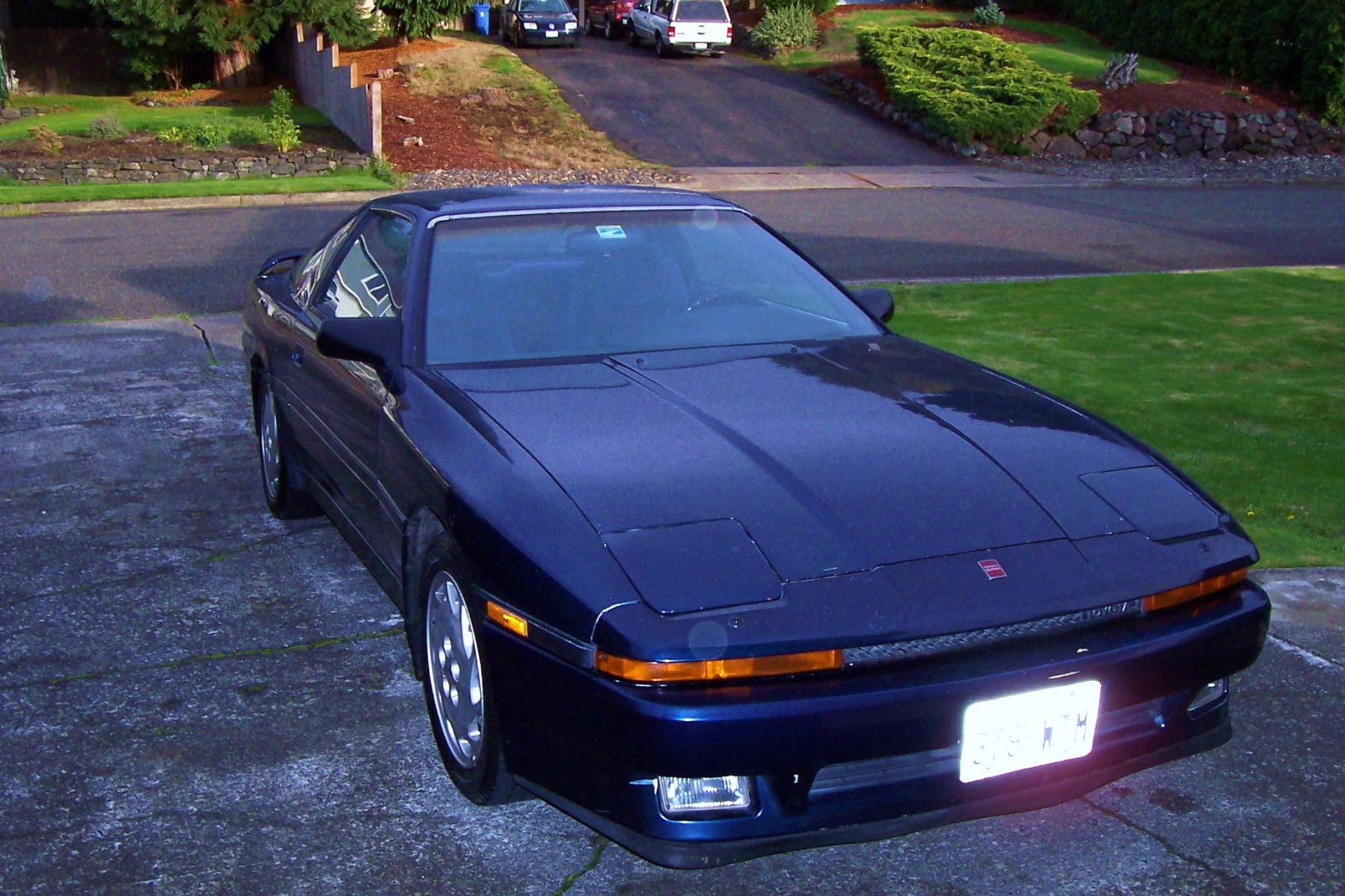

I want to paint my supra, FLAT ARMY GREEN with deep dish rims.
Thanks ahead of time and I appreciate the responses. This is my first mk3 MA70 model supra. I name it Rupert the 3rd

You asked huge questions... First of all, the trim on the hatch (the rubber trim on the exterior) doesnt really seal much, nice to have but not a necessity. Very hard to find used.. new is too expensive. I live with mine being chipped in a couple places.
Second.. overhauled turbo usually means rebuilt and that can vary depending on who did it. No way to tell with the info you provided, but turbos aren't an extreme expense.. I would just be happy with what you have.. for now.
6 PSI and flooring it all the time? Wouldn't worry too much about the turbo.. worry more about the car. It's what we loosely refer to as driving the bag off it...
Straight pipes dont hurt turbo'd engines.. I think you are thinking about naturally aspirated (NA or.. non-turbo) engines (specifically the 7MGE). It needs slight backpressure to clear the cylinders on the exhaust side. 3" to 2.5" just means back pressure.. wont hurt anything really.. it just doesnt breathe like a full 3" exhaust will. Cant get the air/fuel in.. if you cant get it out.
Paint? Depends.. I am spending 6500.00 on body/paint on mine.. but mine is an extreme condition. Not everyone will have all the trim removed, paint the door jams, add a body kit, etc...
Simple paint job (with no body work) is about 1500.00 for a good one. However.. its a MKIII.. so you probably have rust issues (unless your lucky).
You can prep/paint the trim yourself around the windows. It isn't hard, but I dont have the "blow-by-blow" steps to do it or a recommendation for paint. Somebody here will have done it. (or.. you can search the forums)
Honestly.. just by your questions.. I would say.. dont do anything but maintenance on your Supra for a year.. read a lot of the forums (there's so much info here it will choke you), do a compression test and leakdown test to verify your engine state and retorque the headbolts if it hasnt been done lately.
The Supra is an excellent car, but its a steep learning curve to maintain/build it properly and can be very expensive. I waited 2 years before pouring money into mine. At that point I was sure the car wasn't a peice of poop and I had mapped the path out to get it done.

Window Trim: If you want to go back to black on the trim, it can be painted. I just did it on my MK-III when I replaced the rear glass.
Carefully remove the trim. The top plate with the window squirter just pops off the clips. The side pieces are held at the top by a corner piece with an anchor screw, along the sides by clamping a side rail, and slid into the bottom corner piece. The bottom trim is studded through the deck lid, and the 8mm nuts are under the inside trim panel. Be very careful with the side pieces as they can be very hard to remove without bending them.
Sand them down with a semi-fine sandpaper, like 150 to 200 grit. Clean them off good, then hit them with several coats of Krylon Ultra-Flat black. I hit mine with 8 coats.
Fog lights: there is a relay under the dash that controls the fog lights. Before changing out the switch, test it with an ohmmeter. The relay is easier and cheaper to replace with a new one if that is the problem. The switch is soft, and mine doesn't give an audible 'click' either. It does stay in the 'on' position, though.
Paint: Grandavi covered that pretty good. The side molding is held by clips and studs. To remove it for a showroom finish is a big task, since some of these studs are in hard to reach areas. I personally hate the painted over molding, it speaks laziness to even taping things off. Chrome finish? That will be very expensive to get a non-metal surface chromed. I'm sure it is possible, but very pricey. Especially with the Supra's wide molding and wrap-around length.
Paint Color: Olive Drab? Seriously? You can handle that with a box of rattle cans!

Amen just got done doin some body work to mine a month back went to walmart got 15 cans of satin italian olive 6 of flat black did the hood,trunklid, door handles where the trim once went on the door and behind it flat black and the rest satin italian olive came out pretty sick
