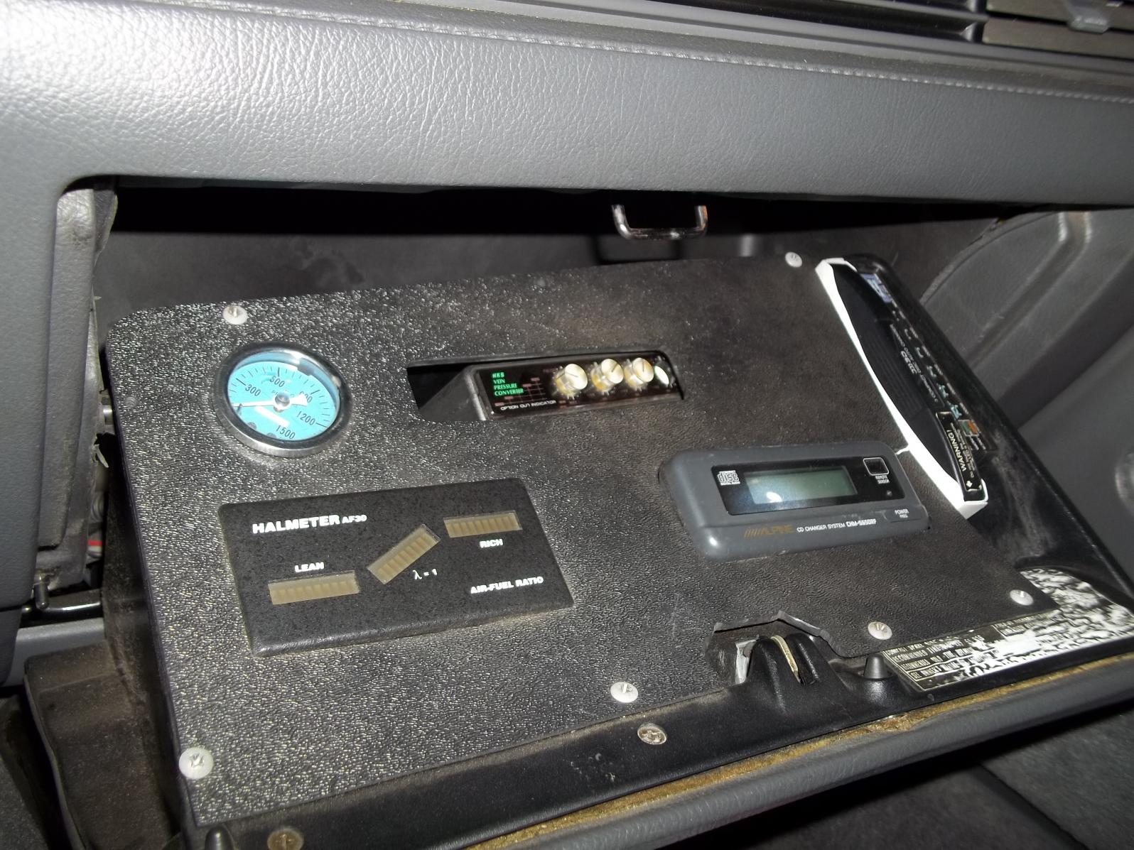

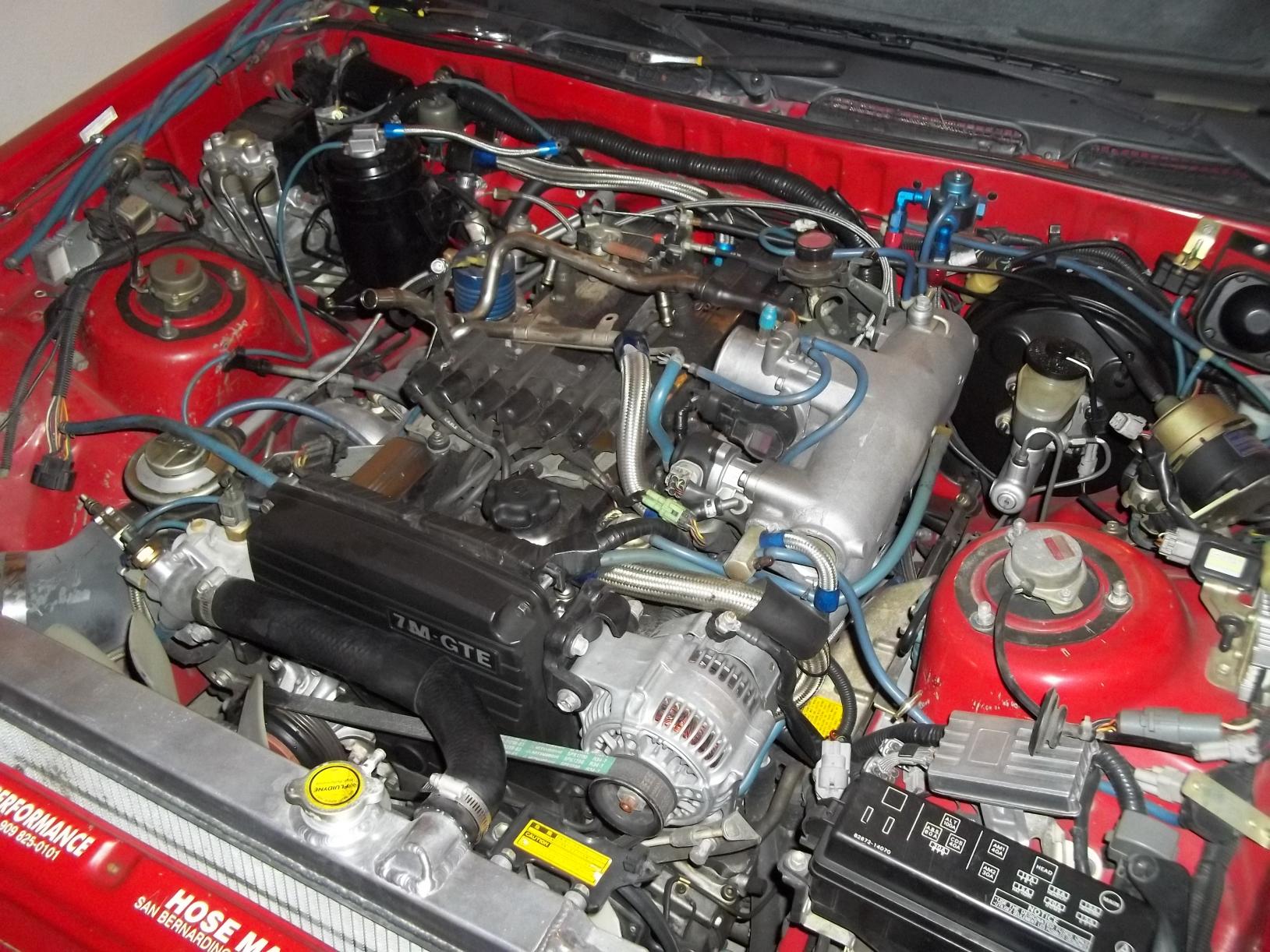

Sorry for the mess at the moment im parting the car out so its kinda like a mess.
Name:	DAVIDS PICS 002.jpg
ID:	4194   Click image for larger version
Name:	DAVIDS PICS 007.jpg
