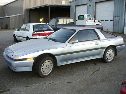

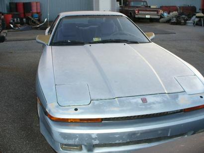

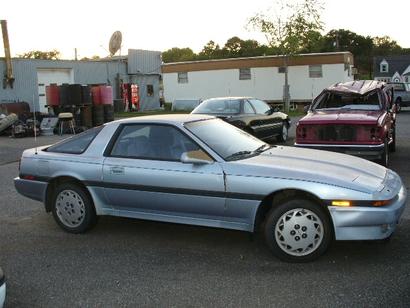

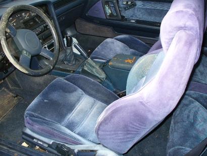

Hey evey one, new to the supra world, and wanted in. i have found a 1987 Mark III with only 45,000 miles on it. old man only wants 2500.00. but heres the questions. WHAT AM I GETTING MY SELF IN TO!!!! i have worked on cars my whole life, I can do just about any thing and evey thing to a car. but i have never messed with a supra or a import car of this age ever, seeing how i was born in '87. but i am just looking for a project car that i will have a fun time working on and a fun time driveing. another question is how hard are aftermarket parts or OEM parts for this bad boy going to be. and how what is required for a turbo upgrade on a 7M-GE I6. where do i fine out what Transmission it is, 5-speed W58 manual 5-speed R154 manual, all i could find on the trans/eng was this HT43.0V5FBB1 , does that make any sence to any one? but thank u for the help ahead of time. here are some pics as well!

First: make sure the thing runs and doesn't have a bad head gasket (very common if your not fimiliar with supra's).
Second: from looking at the pictures I would bet it has ALOT more than 45,000 miles on it to have that much paint fade and interior damage.

It could only have 45,000 on the motor and if it's been sitting out side all these years will do that to the paint And the 7mge comes with the w58 the 7mgte has the r154

With that low of mileage, it probably sat a good bit of the time. So every hose, gasket, belt, seal, and bushing should be considered. Some times a car that was driven with more miles is better than a car that sat for a while and was driven less. It could be a nice project car if that what you want but that paint and interior look like they have seem better days. Just keep in mind that a 7mge with a w58 is not that special.
