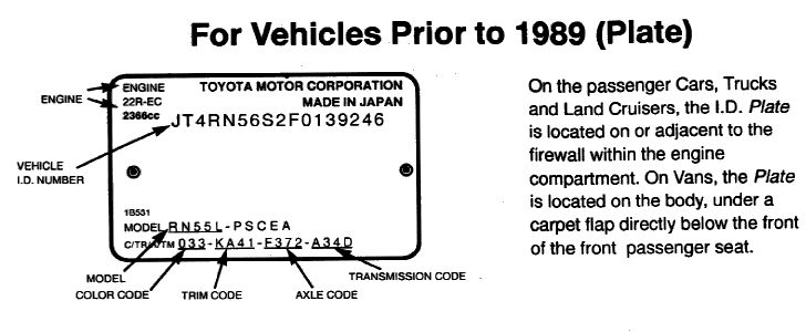

Thumbs up Toyota VIN Explained
This is from some place on the net.
http://www.4crawler.com/4x4/ToyVIN.shtml
http://www.autoinsurancetips.com/toyota_vin.htm
Interesting site:
http://www.eliterides.com/content/view/360/543/
http://www.eliterides.com/component/...er/Itemid,414/

Name:	VIN Prior to 89.jpg
