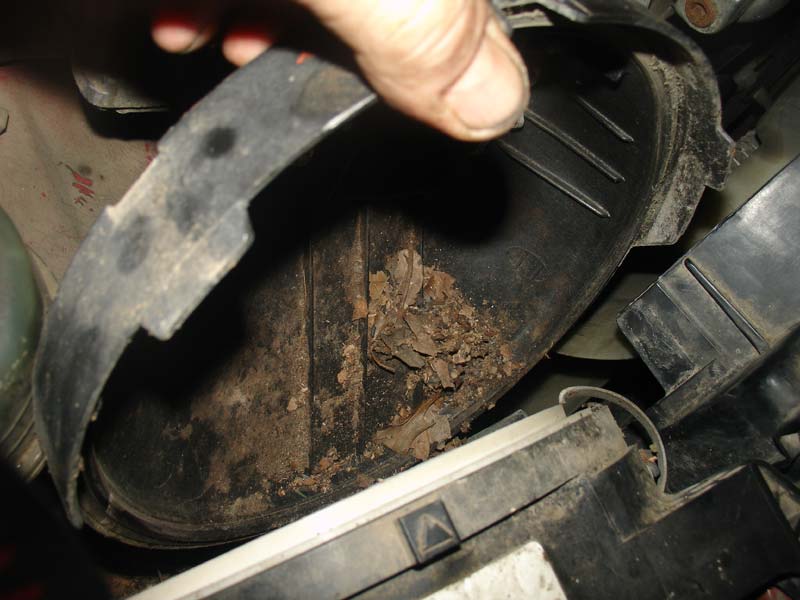

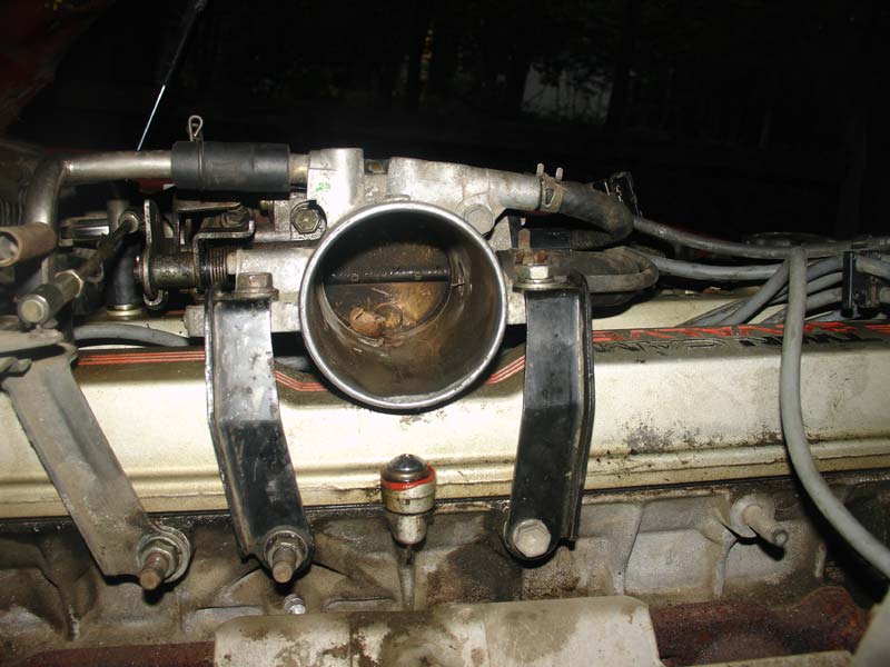

Originally Posted by wstanek View Post
hey had this happen once i started it just b4 buying it and it revved and stayed at 3k so turned it off and lubed the lines and all moving throttle parts its never happened again lol. knock on wood
MAN YOU CALLED THE BALL! I WAS KNOCKING ON WOOD> ACORNS!
VARMITS !!!!!!
Critters had eaten through the air filter and I had a rats next of wood and acorns and crap coming up into my throttle body! GREAT!
I wonder how much garbage I sucked into the motor. Here are some pics. Problem SOLVED! Or created from dirt in the chambers. CRAP!
Yeah I know, I should have checked this! I was just in the test driving stage.....GRRRRRRRRRR!!!! The butterfly was getting trapped by acorns!
Hopefully most of what made it into the motor was twigs, leaves and acorns shoft crap. I put my shop vac into the plenum and sucked it cleanas I could. Was running good hope it keeps going.... Damn VARMITS!
Makes me feel not so sorry for the dead critters my cats bring to the door with their heads chewed off!
