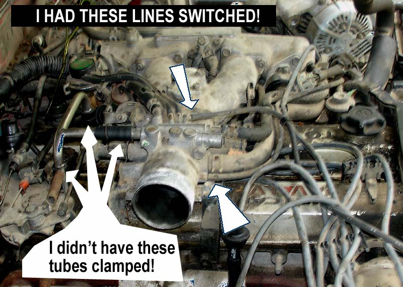

I test drove my Red Supra and it did fine till I gassed it or goosed it. The revs went way up and stayed up I had to kill the ignition with the Key to slow it down. After shut down and restart it did fine till I goosed it again and then the same thing happened. I brought it home and parked it.
What does this sound like? The linkage looks to be fine. Could a Vacuum problem do this? an intake leak on the plenum I just put back on? Has anyone ever seen this happen before?
Edited later.
I did a search on this forum and found someone saying that vacuum lines swapped or a vacuum leak could cause revving.
Luckily I photographed my vacuum line positions before I took it apart. I found that I had swapped lines to the Plenum. I also did not have the metal T tube hoses all clamped. Should I re-torque the Plenum bolts? Could this have caused it?
Thanks, Scott
