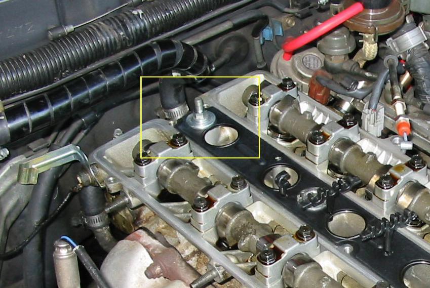

I have another somewhat related question. I noticed that the last 14mm allen bolt (closest to firewall) holding down the #3 gasket has a threaded hole in it. Am I possibly missing something? Is there supposed to be a bolt in this hole?
Edit: OK, so I see in this photo there is a bolt (and possibly a washer?) in that hole. What is this for and should I worry that mine is missing?
