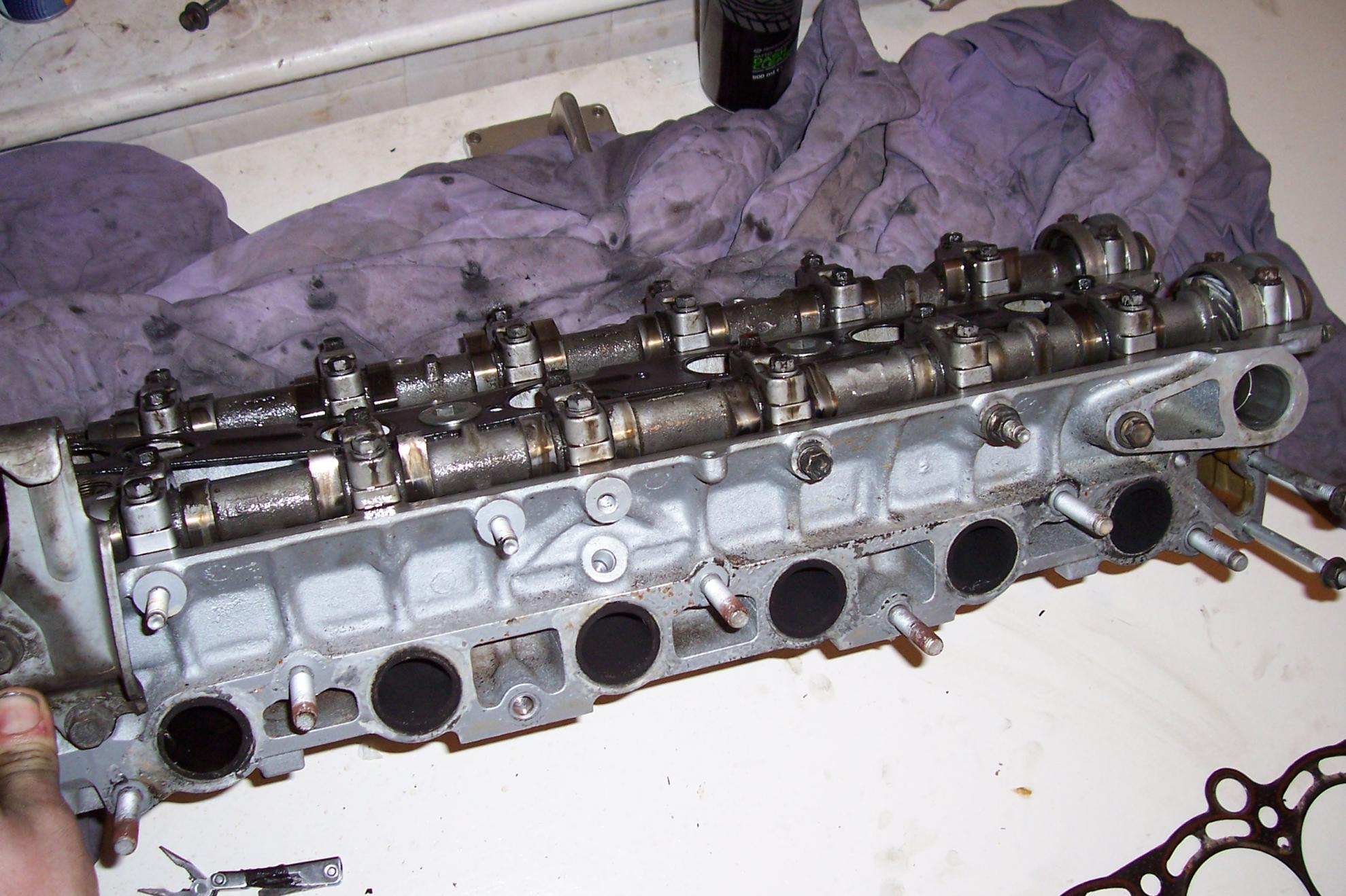

So after the struggle to free the turbo, the final stripdown of manifold, cam covers & head was pure simplicity, only hindered by having to grind down an old 12mm allen key to 10mm for the head bolts. (incidentally are 10mm allen head bolts stock? I thought stock was studs/nuts from some descriptions of HG jobs, which said about removing the rear 2 studs to get the head out). Either way they were none too tight & I'm going to take the head into the shop to check warpage 'cause I don't think they were even 58lb!
So to the actual problem, you guessed it - number 6 right at the back edge... I'm not surprised these suffer airlocks looking at the design, the rearmost water jacket on the block has no corresponding channel in the head does it? And this is exactly where it blew... Come to think of it, the head to block mating area as a whole doesn't look overly well thought out to my eye. I'm talking about the intake side water jackets which are completely mismatched from head to block. What's the reason for this I wonder? If this doesn't sound right I'll be posting some pics tomorrow anyway.

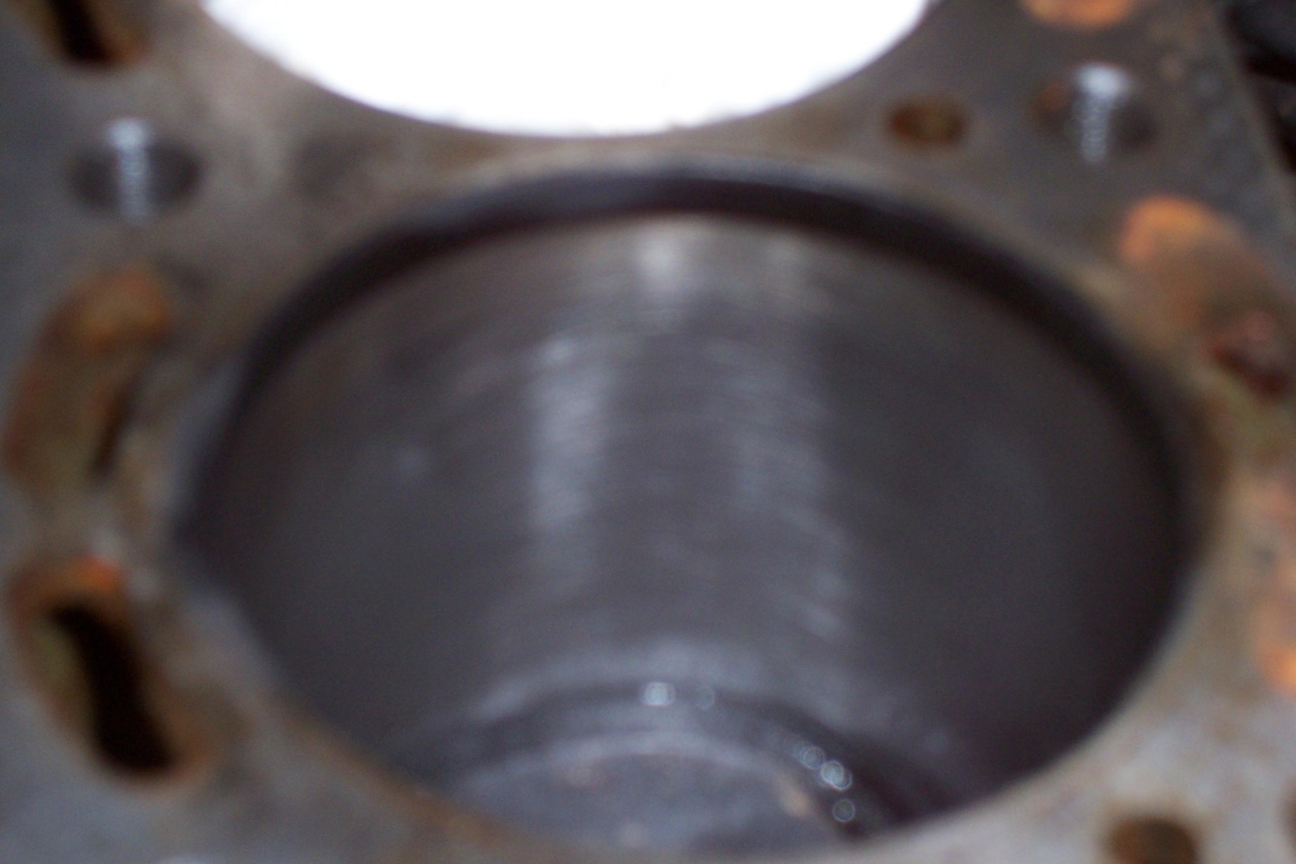

The plus side of all this is I got a nice surprise when I looked at the pistons & pots, lovely cross-hatch marks still in every bore & brand spanking pistons with just the lightest coating of carbon (unsurprising considering how rich it ran when I first saw it!).
