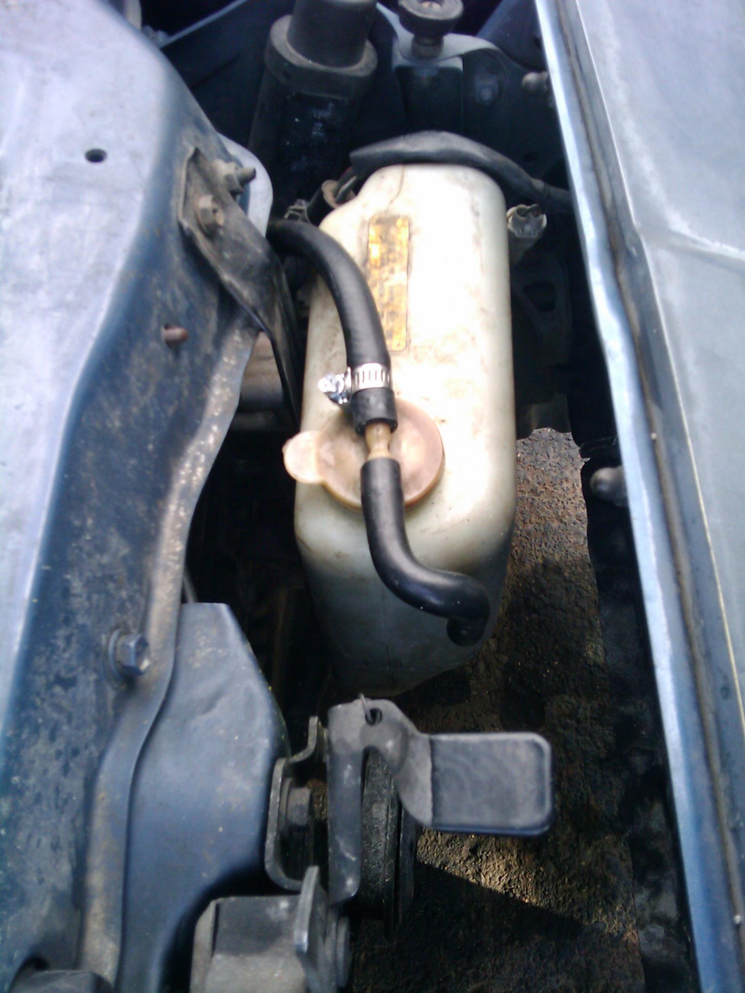

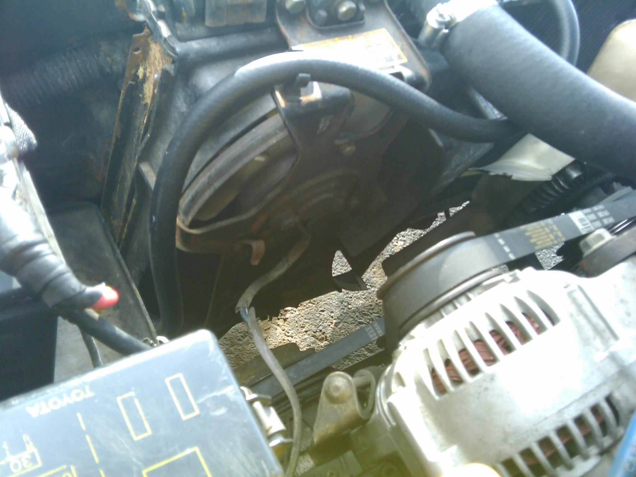

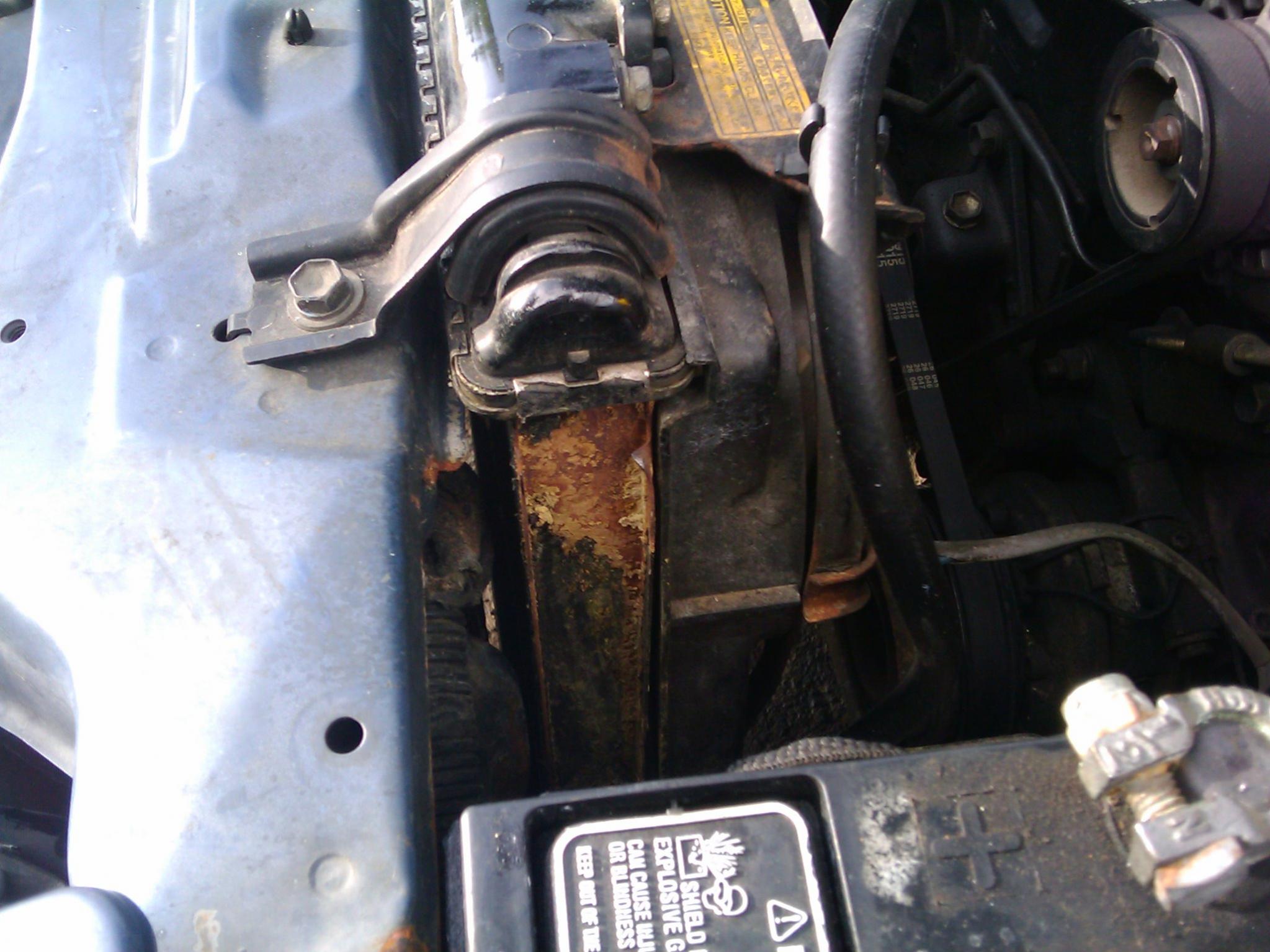

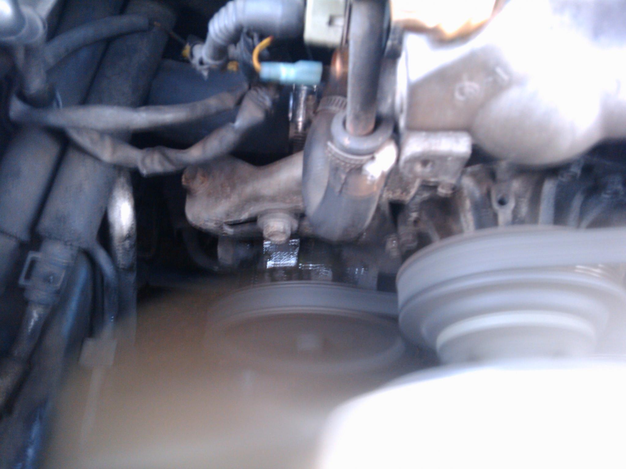

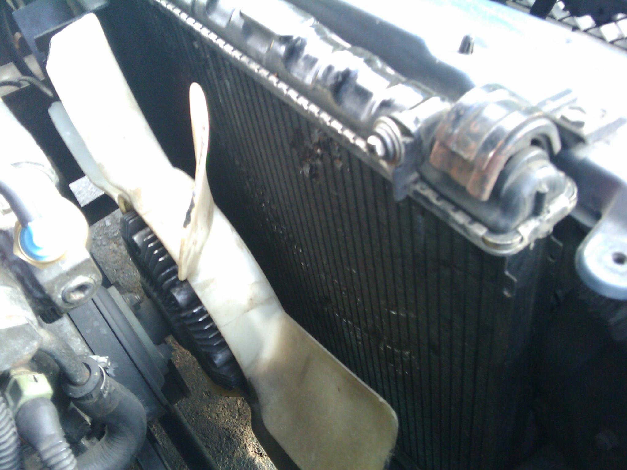

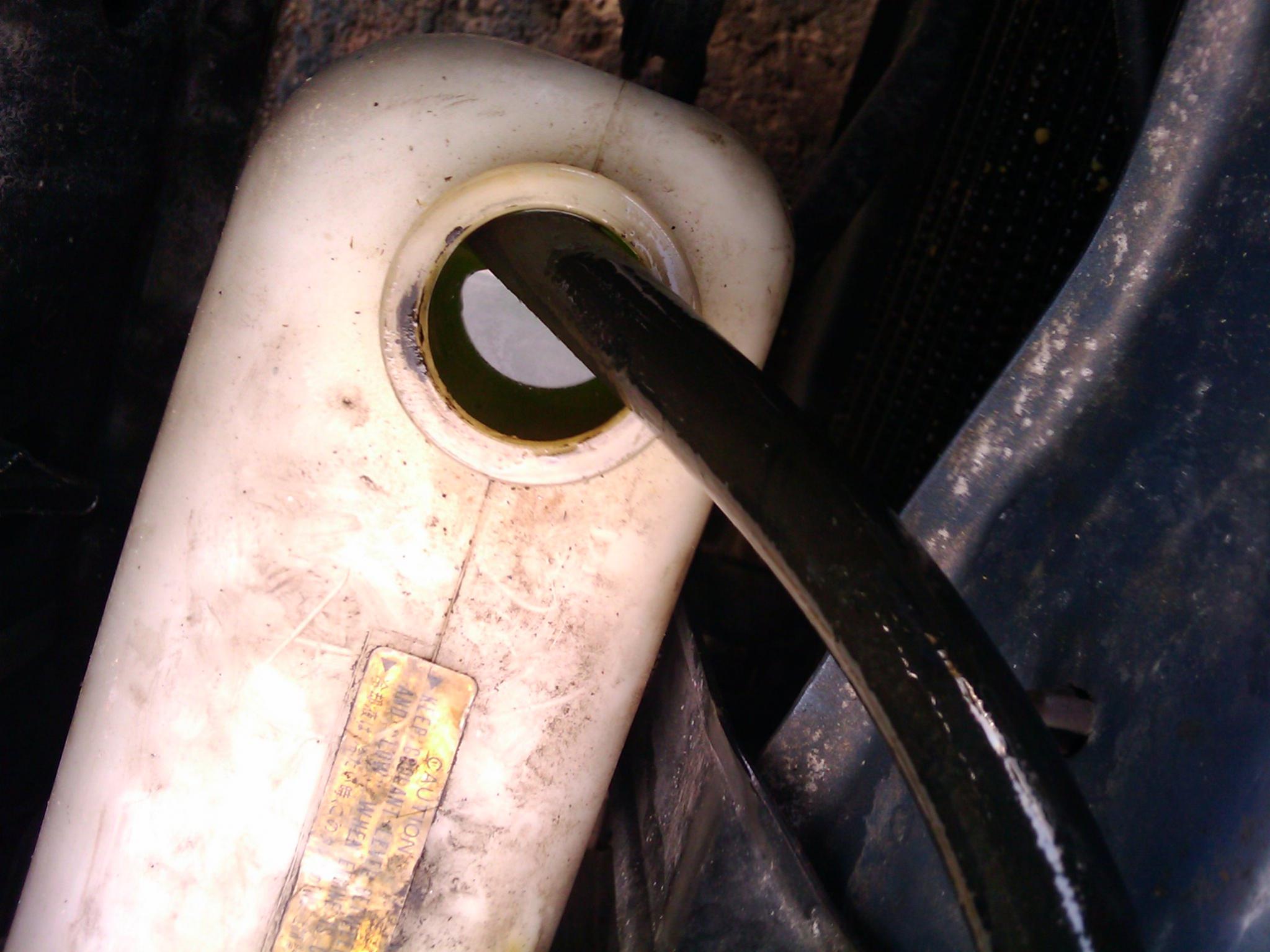

Here are some pics that I took today of my expansion tank, radiator, and water pump.

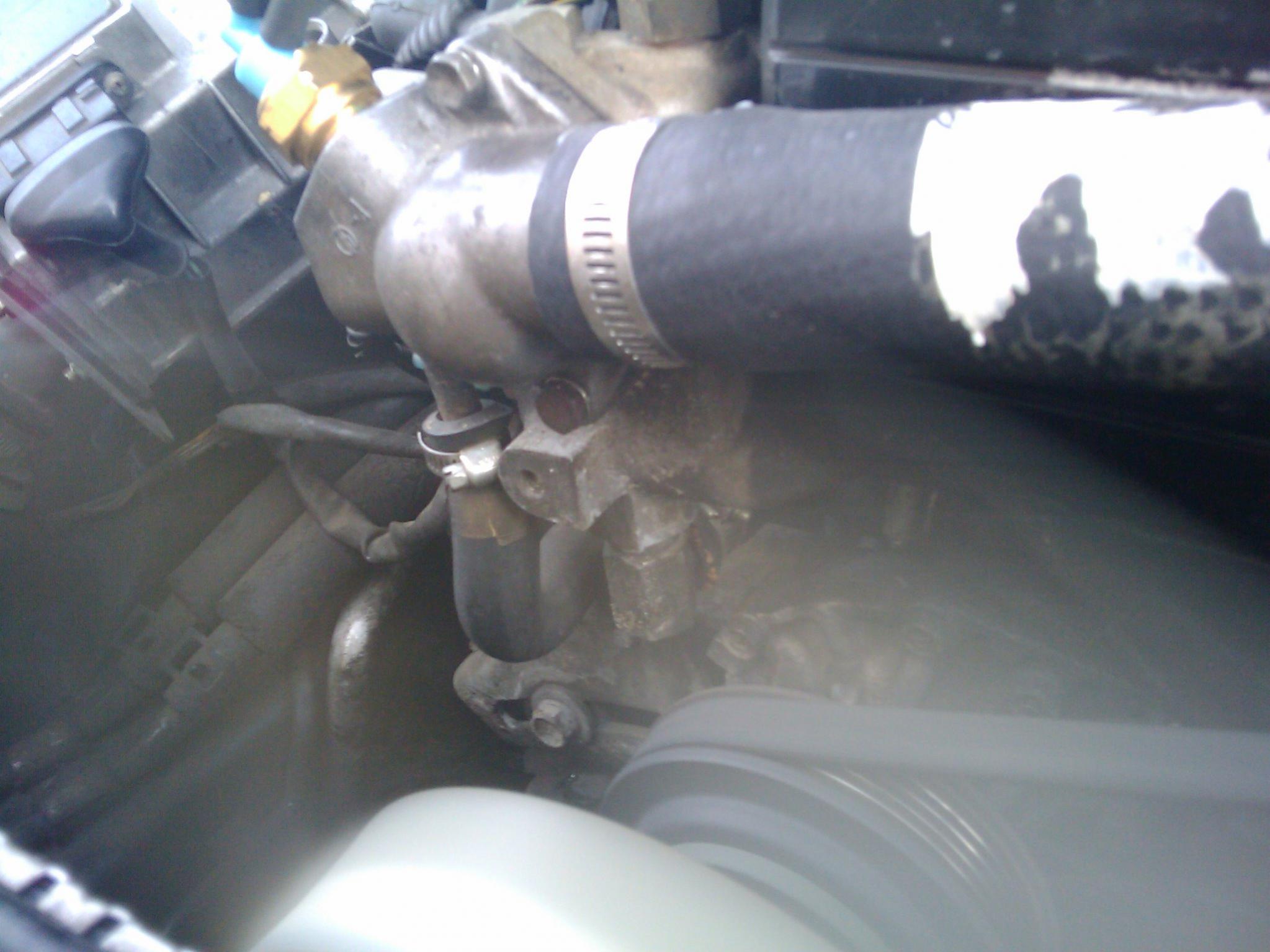

OK so this morning I when to check out my radiator again and to my surprise for the first time the radiator sucked up the coolant from the expansion tank it wasn't filled to the brim like it has been all week. So I start looking around and notice a drip coming from a hose above my water pump. Could this be the culpert or is it in combination with a faulty water pump?

Any leak in the cooling system will result in it not easily sucking the coolant back from the reservoir. As the coolant cools down, the pressure drops which creates a vacuum in the system. This is what draws the coolant back in. If there is a leak, the cooling system could draw in air (which is easier for it to do) instead of that coolant, leaving it all in the reservoir

Ok thanks btwilson86, I did find that there are two hoses that are adjacent to the water pump are swollen. I purchased a brand new water pump today just in case and it was the last one that they had in Denver out of all of their stores; and I'm going to change out the two hoses and see how that works. Would you change out the water pump just to be safe? I don't have any idea of all the parts on the engine; if I had all the money I needed I would replace everything with new parts just to save the headache for at least another 22yrs...lol
