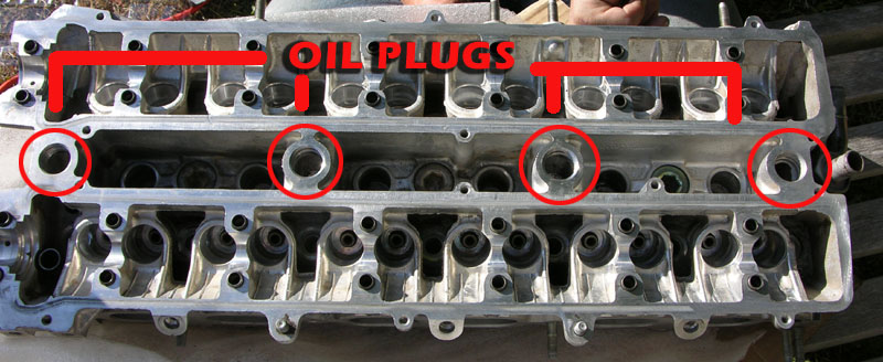

The 4 plugs on the NO3 Oil Cover are leaking - very common.
Its the black plate over the plugs.
They go right to the valves.
Put Oil plug washers on them and RTV
There is a geat sticky on this topic on the MKIII form

Oil in the spark plugs leads to misfires, destroyed spark wires and if hardened, impossible to remove plugs.
Not to mention the tar that will develop over time. Should take care it.

Are you saying oil on one side of plugs, or both? I have 89 supra and doing same, but covered in oil on both sides. The problem is oil plug washers??? How is it getting to both sides of plug and all over coils? thanks.

I have done mine and all you need to do is to remove all of the parts like you was going to change your plugs out and take a 14mm hex socket and remove the hex bolt put the gasket with the RTV on both sides of the gasket and place back in; be careful not to tighten it too much or you'll crack the gasket. Or you'll have to repeat the process. Also, make sure to clean out your spark plug galley from all the oil and replace your plugs with new ones and check your plug wires and replace and or clean off as needed.

but the plugs are only two weeks old, do i still have to replace them?
