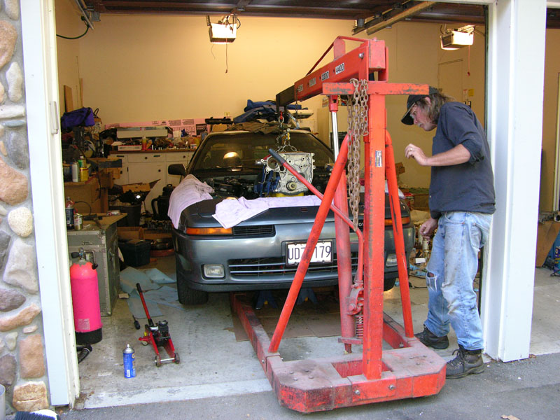

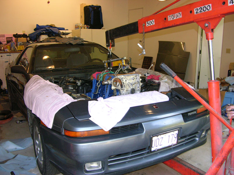

oregonjoe 09-09-2009 06:04 PM
Lift
2 Attachment(s)
Originally Posted by Blackdog (Post 72875)
oh i see. Well i doubt ill get a kit from any shop around my town lol But i hope im as lucky as you with the block getting clean and all. It wld be nice not to have to replace all that.
Did you remove the block yourself?
Just me and my little friend – a 4000 pound engine lift.
Attachment 2335
Nice little tool I borrowed. All hydraulic with a few control arms and engine leveler to fine tune the lift in and out. Was able to pluck that block out and back in with fine precision.
Attachment 2334
Every weekend mechanic should have one.
Blackdog 09-09-2009 08:46 PM
haha heck yes, too bad i cant afford that lol
