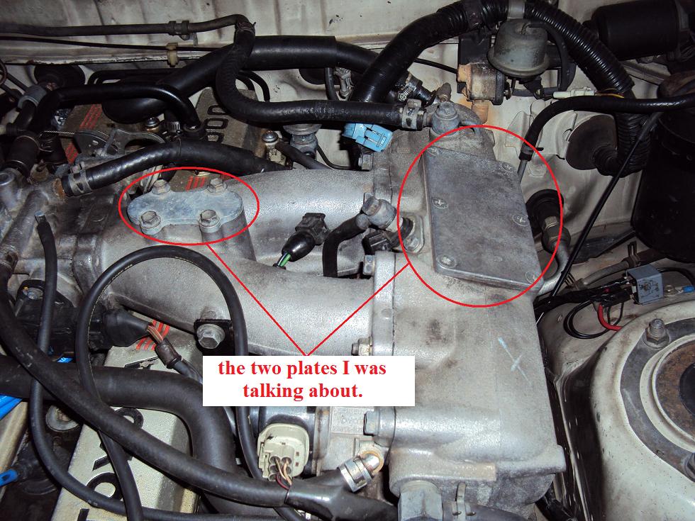

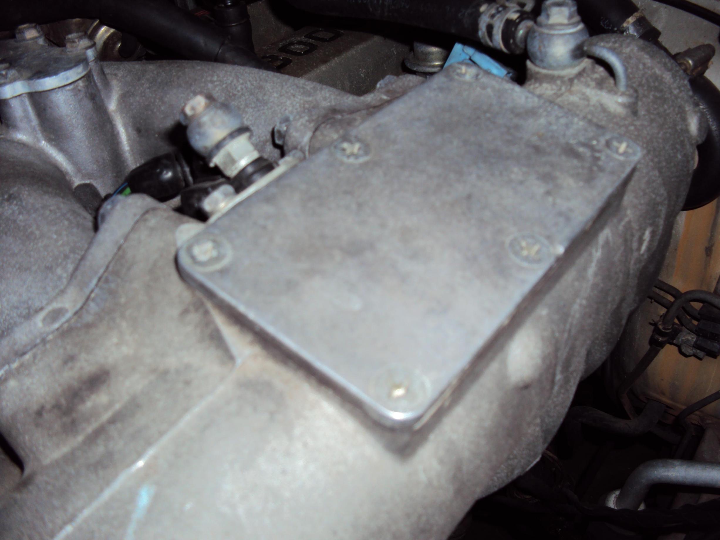

ok so ive taken a pic of my intake manifold and the back of the head where the nok sensor bolts into the head and exhaust...
so if any1 can tell me if this is normal N/A intake and head or if its turboed head etc.
Attachment 2336
Attachment 2337
Attachment 2338
Attachment 2339
87mk111 09-10-2009 03:05 PM
looks like an original NA to me.

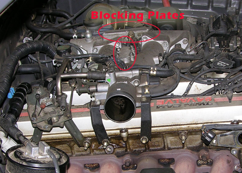

1 Attachment(s)
Mine is a NA and it has factory plates on the intakes.
Hera is a picture before disassembly. The plate just after the Throttle body is a PVC or EGR port because it was filled with soot and tar.
Attachment 2340
The rear plate on the Air chamber is where I think the turbo would go? There is a vane valve there to crossover the air intakes at wide open throttle
Notice the Throttle body and air valve are completly coated with emissions tar before I cleaned it all up. This steals horsepower.

Plates
[quote=*D-Joker*;72946]ok bare with me ppl i think i have figured out the trick to it hahaha
i just hope this works...
What you call the NOK port is an EGR port here. California Emissions code required smog devices so and EGR valve would have bolted to that port - looks like you did not need it - good thing too because the EGR gases plug up your intakes after awhile.
The oval plate after the throttle body is also part of the EGR emissions system. It appears to route exhaust from the head through the AIR CHAMBER to inject it after the throttle body.
Funny how these plates are located on the drivers side here :)
