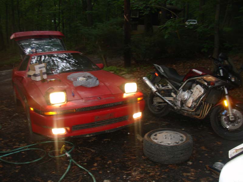

I did get the fog lights put in. Turned out I had purchased them from ebay sometime over the past 7 years. Here are pics of the install.

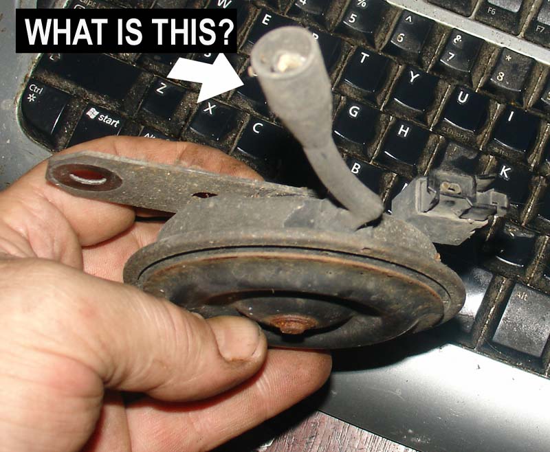

OK I continued on reading other forums and found some info and things to try for the horn
Removed the passenger side horn hooked it directly to the battery and got nothing out of it. Went up to my black Supra took offthat horn tried the same thing nothing happened. The wireing to the black Supra horns ismissing or busted off.
Didn't have a voltage checker so I went to my boxes and found a Honda Shadow motorcycle turning signal.

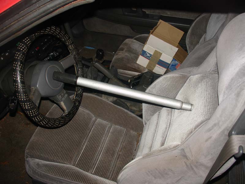

I took my jack handle and wedged in-between my drivers seat and my steering wheel horn pad (button)
I attached some speaker wire to the ground post of the battery negative terminal and touched the other lead from the turn signal to the horn terminal positive wire.... and I got light! So I know I am getting power from the horn so I figure my horns are bad. There is a boxed contact on the horn and then there is a rubber sheathed something coming off the horn. What is that rubber sheathed thing? I have attached pics. I am wondering how the horn gets its ground because the arm it mounts onto is painted and does not appear to have ever given a ground to this horn.

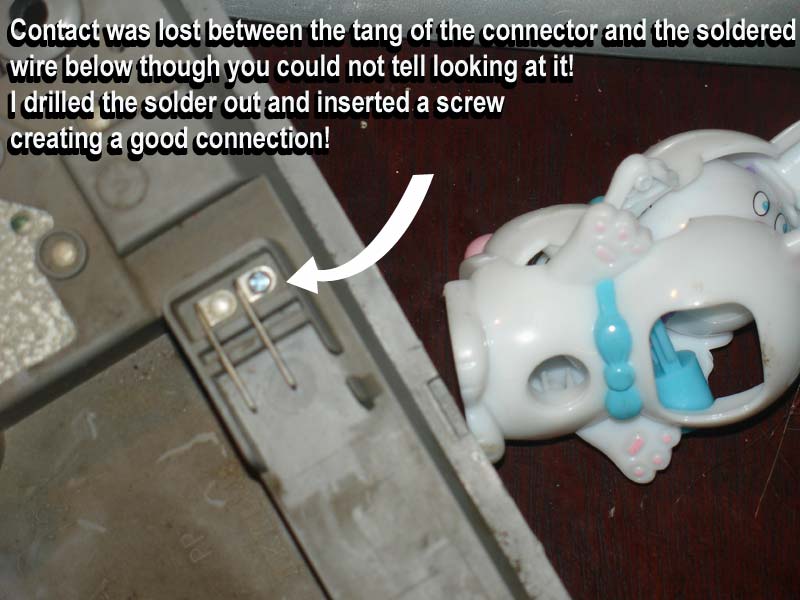

Well as luck has it I found a fix for the dome light before anyone could answer my questions. Here is how it went:
After reading how soldering was required and also reading somewhere else that someone inserted a screw somewhere, I took my battery charger, attached the negative to one connector terminal and then started there, Immediately I found the problem. One of the terminals on back of the unit was no longer connecting to the wire underneath! It looked perfectly normal but if I touched power to the center of the rivet it lit up, but if I touched the power to the tab that was connected to the rivet and has the tab that goes in the connector, no light!
So I new this was where the rivet was somehow not connecting. I was lucky in that it was the first contact point I checked. It might be the very weak spot on all these dome lights or you might have to test and search for yourself to see if you have a bad riveted connection on your light assembly. Remember they will appear to look perfectly connected and riveted!
I didn't feel like searching for solder and my soldering gun. I have not soldered anything in many years and as I recall I sucked at it. So I got my drill and a small drill bit and I drilled the solder out.
I then needed to be lucky enough to find a nice small tapered metal screw that I could use in place of the solder. My first thought was.... McDonalds Happy Meal toys! I had to look pretty good to find a small happy meal type toy that had a phillips head instead of the weird triangle screw head.
I found an Easter Toy that once topped a plastic container of candy. I pulled the bunnies screws and Whallah I had a screw that would work. I ran the screw through the open loops left by the rivet being drilled out.
I tested the light and it worked fine! I installed the light back in my Supra and so far so good. Of course I can solder it later if this does not hold but I took a pic for you guys because no one had actually shown what they did.
Check out the last pic to see the screw ran through the connector tab and into the eyelet on the other side that is attached to the positive input lead.

My Horn works now, only bought one for now from auto zone for $16.00 thats all I need to pass inspection. Will get the other in a week or so.
