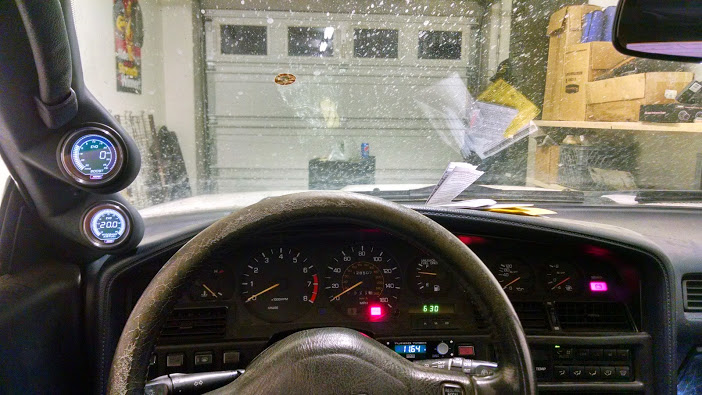

Snow is falling like crazy here in Montana, so I went ahead and took care of one of my winter projects: Installing ProSport EVO series gauges, electrical boost and wideband AFR. These were installed into a Lotek A-Pillar Pod (review to follow)

I'm happy with both the gauges, pics show them in both day and night. The night pic actually looks worse thanks to my camera; they are bright, but it's not obnoxious and is still easy to see.
