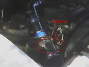

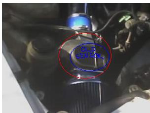

i tried to make myself a cold air intake system , evertthing was godd escept i cant atke out the airbox which basically ruins it for me i got the pipe where you can jus put the O2 sensor in and it all should be alright but one problem, it was made for toyotas 98 and up, now i was jus wondering if i buy a 98 up O2 sensor from a dealership and do they have the same amount of wires so i can jus simply remove the old sensor and put it in so i can complete my project or will this ruin the stock system on an 88 mk3 n/a
if possible tho what car would have similar wirings as a supra

The item in the photos is NOT an 02 sensor. It is the Mass Air Flow sensor. Your car won't run without it. It is a calibrated part. If it ever fails, you (probably) can use one from a different year.
02 sensor is in the exhaust manifold.

You're stuck with the AFM. Unfortunately the car won't run without it, or extensive other mods (read: standalone)
It's easy to work around, so I don't know why it's a big deal. Just put the piping on the adapter that your filter bolts to, then clamp the filter on the end of the piping somewhere behind the fog light.

Well, I always wondered if you could put the AFM straight onto the throttlebody using a short hose. Then you could run a 4" CAI to the AFM intake side with a step down adaptor like the ones I saw at PepBoys and AutoZone that come with those cheap cone filters (1 size fits all).
And like said above, put the filter behind the headlight/fog light. Or even in front of the a/c condensor/intercooler.
