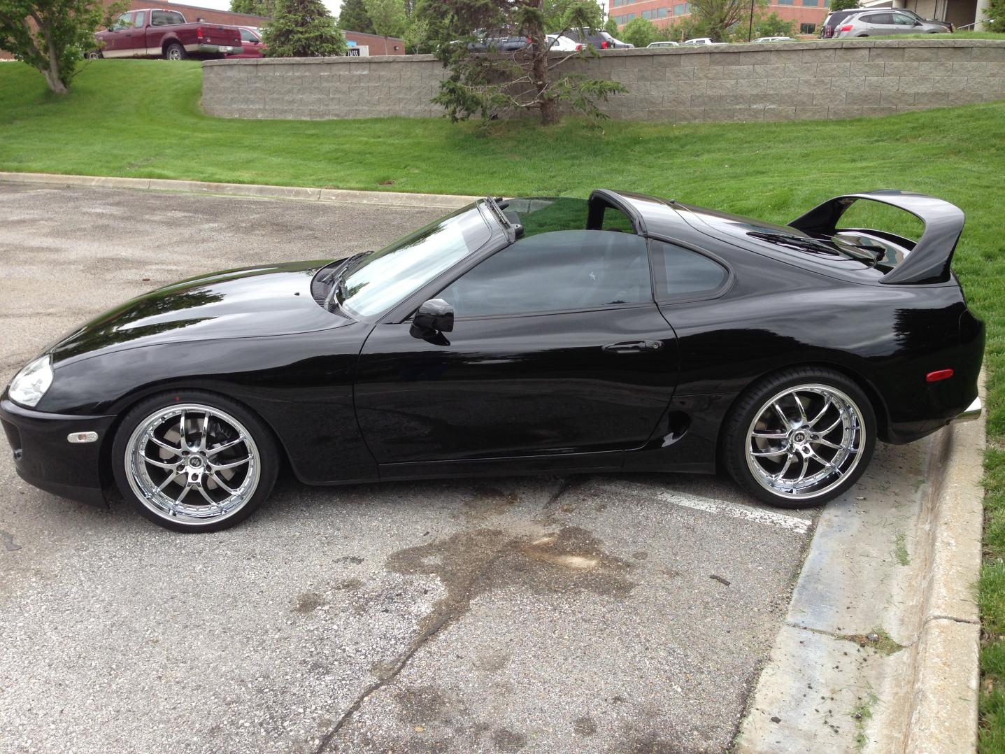

I just put these on my Supra a couple of months ago, but be aware of this, get the right wheel fitment for the supra, aka the right offset, just cause they say they will fit doesn't mean they fit correct, i love the look of my new wheels, but they have been a pain in my ass, I have coil overs and have to take it in to get raised again, or I have to roll the fenders because my offset is not right so the new wheels stick out further then they are supposed to. I don't know what I should do I can get you the offset i have so you don't make the same mistake i did, but I agree wide wheels on a N/A is kind of beating a dead horse.
Thanks, that would be greatly appreciated. I was about to pull the trigger on another set of wheels but honestly I'm scared of getting some with an incorrect offset and the wheels won't look the way I want.
