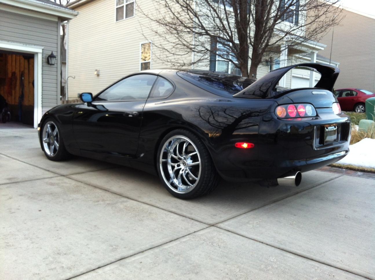

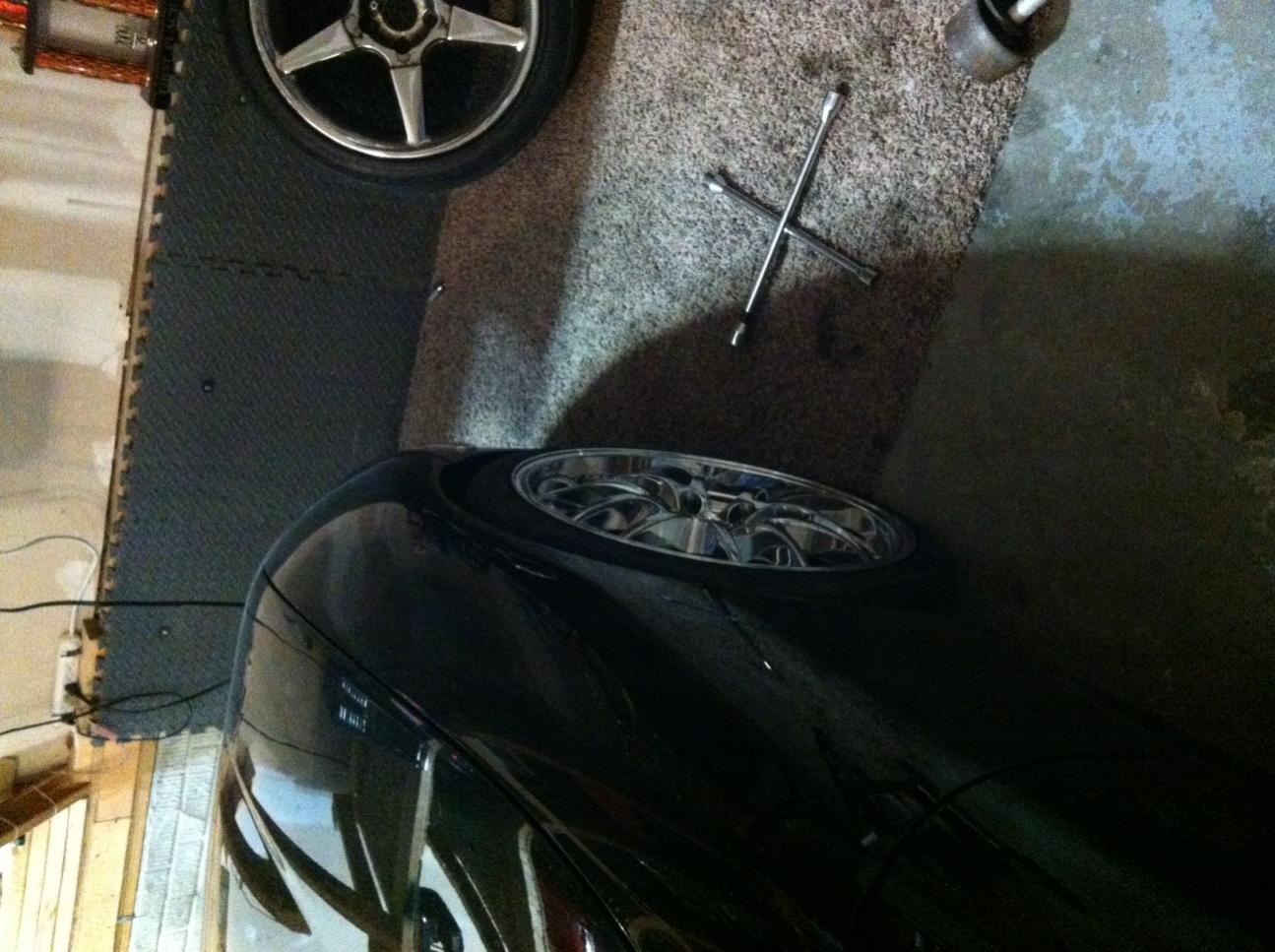

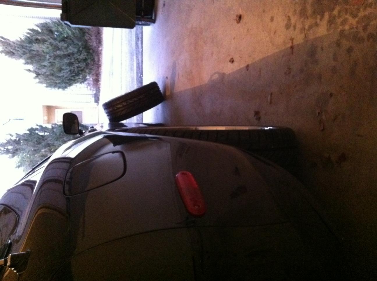

well they fit on the car fine, but they do stick out a little bit in the rear and a tad bit on the front. I don't know if thats bad or not, they rub a little bit on the arches but won't the coil overs allow me to correct that? Those are installed tomorrow. Here is a picture of the old & new,
Yes, most coilovers are height-adjustable. However, note that as you increase the height you (usually) also increase the preloading on the spring which may cause (for example) a bit of a harsher ride (among other things).
