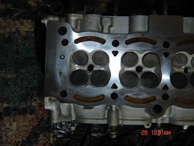

well anyway i took it to another more reliable maching place (carquest) they use a diamond cutter instead of a stone. he said they fucked up on a corner of the head so he had to machine a little farther down. another $60 down the drain.
so that machine shop really sucked a lot of dick then. i dont even know if they did a valve job and replaced the oil seals. ill post some pics of the head when i pic it up tommorow.

$60.00 is a small price to pay for the repair. It's probably the best 60 bucks you could have spent thus far.

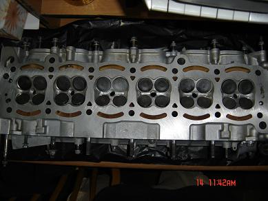

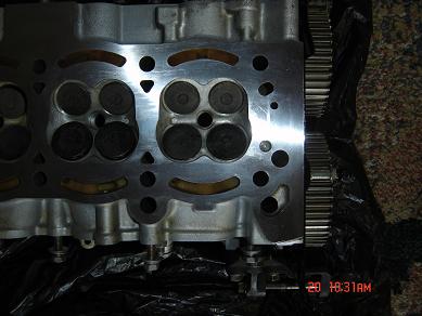

your right it was the best $60 i spent i got a boner when i saw it. heres some pics. the last one is what it looked like before. the new head is 4.563".

It looks good man. I guess you are just going to have to live with the gouges.
I would use an HKS beaded hg, If not the toyota oem replacement. I guess it depends on what you want to do with the car.
