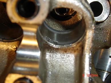

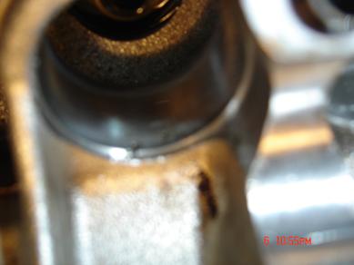

i was told to take the valves out of the head to get the head machined. is this true? that should have been my question before i started taking the vavles out. i went a bought a valve spring compressor. this was the shietiest thing i ever saw. first the thing i got with it to push the spring down didnt even fit on there right so i had to mod it a little. even then it didnt work right and i went to push the spring down and i scracthed were the lifter goes and i think i fucked it up cause the lifter wont fit into its spot anymore. wtf do i do?? can i sand it down a bit or not? please help. thanks

here is the pics

You do not need to take the valves out. You just need to take the camshafts out because the valves will close automatically and you will have plenty of space to resurface the head. That is what I had done to my 87 Turbo Supra.
Also by looking at the picture, I would say DO NOT sand it down because that could throw off the OEM clearences and I would not even try to put that togther.

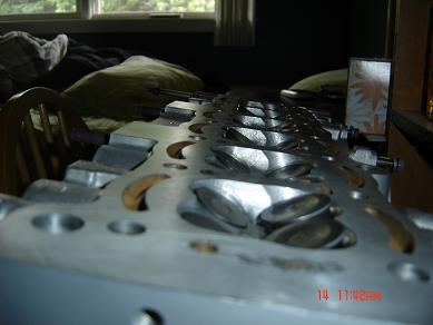

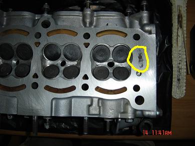

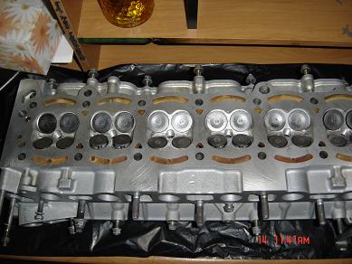

just got the head back today. cost $400 for a mag and mill and then a valve job
taking the block in next week
there is still a little gash do think it will effect anything? (second pic)

Old 06-15-2007, 02:14 AM   #10
Have a better picture of the "gash". The surface looks a little rough, if you're going with an OEM HG it's fine if you're going MHG I'd lap it.
