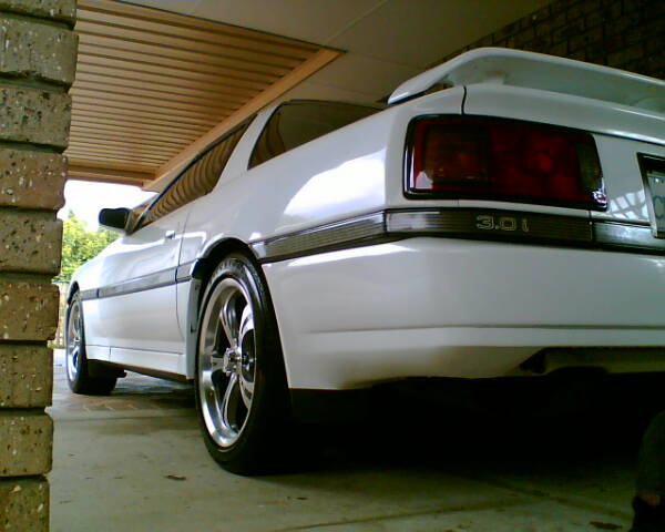

I got mine chopped nearly three years ago and no problems! I can notice the difference in ridgidity when the roof is off, but it isn't bad. No doubt , if you were racing round a track, you'd feel a fair difference but for normal driving(with a bit of occasional fun), it's fine.

I paid about $800AUD for the roof(New roof from the door level, up). About $1400AUD for the job. The hardest part is letting someone chop up your Supra! Well worth it as far as i'm concerned.
