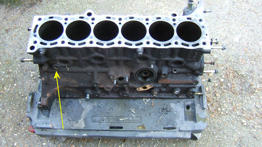

i got an 87 supra and im trying to change the coolant and i cant find the plugs. the tsrm isnt realy helping because there are so many things under there. please help. thanks.

Drain plug for block: under exhaust manifold at the rear (see photo) Drain tap for radiator: bottom right under radiator, you mentioned a small rubber pipe sticking out of the bottom of your rad in previous post, well this is where the tap is.

i so i take that thing off or what do i do?

The rubber hose is attached to a drain tap, turn the tap to drain the radiator also remove the rad cap.

To drain the block remove the drain plug (in photo) completely.
