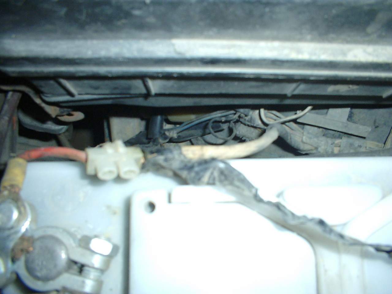

My A/C was not working when I got this car. I discovered that the magnetic clutch on the A/C compressor was not hooked to anything, there is just a broken wire hanging off of it. I can not find where this hooks to.
I found the information that this wire goes to the magnectic clutch relay, and there is normally a connector on the end of this wire (though I dont know what the connector should look like as mine is gone)
Can some kind helpful soul please go look on their car and if possible take a picture of the connector? Also if you could note where it plugs in, and what the color of the wire is that this plugs into for me?
I do have a wiring diagram from an online manual but it doesnt show wire colors or the location of the relay. Any information would be helpful. Thanks

I havn't done any work on my AC system I have a mechanic who does that stuff but I shot 2 photos which are attatched. The wire from the clutch goes to a connector which has 2 blue wires that go under the fuse/relay block.
I didnt unbolt that so I don't know where they go from there. Hope the photos help.

yep, that did it...thanks, those photos made all the difference...I appreciate the help greatly!
